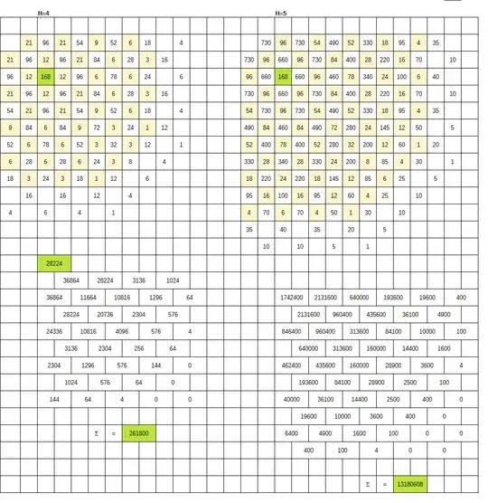

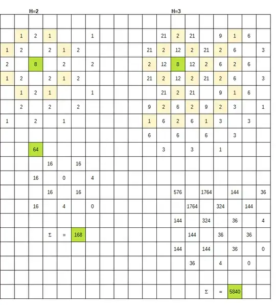

Easily to see that the length of the closed walk of the chess Knight is even. Assume it equals to $2H.$
Let us build the maps of the possible paths to the available positions of the figure for $H=1,2,3,4,5,$ using the previous (colored) map as the base for the next one.
H=1,2,3
The starting field in the all maps is colored to green. The map for $H=1$ is colored to light gold on the left picture and looks trivial (8 avaiilable fields with the single possible paths). This map is used on the all maps as a template for the summation of the paths quantities for the next map. Summation can be executed manually or via the electronic tables.
All calculations are executed only in one quadrant of the chessboard. The other fields are filled by the symmetry.
The total square sum counting is executed in the tables below. The green cell contains the square of the number in the green ceil of the map above. The white cells contains the squares of the cell of the map above with the factor 4. Since the higher map on the full chessboard are symmetric, then the total sum of the obtained map equals to the total square sum on the full chessboard.
See also the comments of miracle173.
H=3,4,5
Every Knight path consists of $H$ moves to the certain field and $H$ moves to returning, with the same quantity of the possible paths in the parts.
Therefore, the total sum of squares over the map for the halflength $H$ gives the quantity of possible closed paths of the length $2H,$ wherein this claim can be easily checked for $H=1,2,3.$
Thus, $$N_2 = 8,\quad N_4=168,\quad N_6 = 5840,\quad N_8 = 261800,\quad N_{10}=13180608.$$

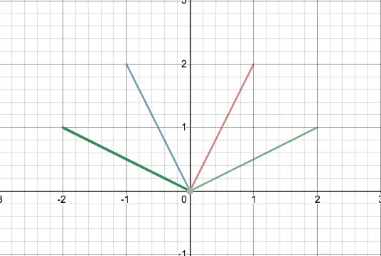

Note: this answer doesn't have a complete solution to the 10-move case.
There's a few ways of thinking about this question. It seemed as though each avenue I went down hit a point of ever-increasing complexity as I tried to apply a method for the simplest case (2 moves, 4 moves etc) to the more generic n-move problem.
As I said in the question, there's 8 possible moves:
Each of these 4 and their equal and opposite (inverse) moves. The exclusion of the other four is deliberate and comes up later.
For the 4 move case:
The knight can either -
  • Make one move, move back to origin, make another move, and move back to origin again, which has 8x8 = 64 permutations.
  • Make one move, make the same move again, and then can only move back to the origin one way, which is by taking the inverse move twice. This has 8x1 = 8 permutations. EG take the red move twice in a row, then take the inverse of that twice again.
  • Make one move, then take another move which is neither the same move or the inverse move, then take one of two ways back to the origin, which is to retrace the path (EG red move, green move, inverse of green, inverse of red) or take the way back to the origin which draws a parallelogram, illustrated below:
There are 8 first moves, 6 moves which are not the same move or the inverse, and then 2 ways to get back from there, so 8x6x2 = 96 permutations.
The sum is 64 + 8 + 96 = 168.
This is confirmed by rain1's link: oeis.org/A254129.
It is difficult to use this brute force approach for 6, 8 10 moves. As you can see in the link, the formulae found to compute A(n) are quite complicated.
A (slightly) more robust approach is as follows:
For the 10 move case, we take 5 moves from the 4 possible moves pictured (combinations with repeats). For each move that we pick, we need to take the inverse of that move in order to 'undo' the path we take. We're not placing the moves in order, we are simply taking some combination of 5 elements comprised of the 4 possible moves (EG red,red,red,blue,blue = blue,blue,red,red,red), and then assuming that we can only reverse this path by taking, for each move in the group of five, the inverse of that move. The combinations would be given by the terms in this expansion:
(x1 + x2 + x3 + x4) ^ 5.

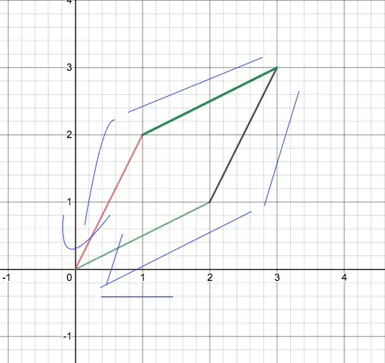

Let's do this for the four move case. We first pick two moves from the possible 4:
  • Take the same move twice. EG take red twice. We can do this 4 ways. For each group of 2 moves, the only way to undo this is to take the inverse moves. In this case, if we take 2 reds (the vector (1, 2)) then we must take the vector (-1, -2) twice to make a path back to the origin. So with those 4 moves, 2 of them are the vector (1,2) and two are the vector (-1, -2)and we calculate the permutations using the formula for permutations with identical elements:
    4! / (2! * 2!) = 6
    4 ways of doing this so 6*4 = 24.
  • Take 2 distinct moves. EG red, green. We can do this 4C2 = 6 ways. Then we must take the two inverse moves, and our path is some permutation of the group [ red, green, inverse red, inverse green]. This has 4! permutations. So 6*4! = 144.
The sum is then 144 + 24 = 168.
