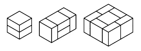

Consider the line determined by $(x,y)=(a,b)$ and the four regions into which the planes $x=a$ and $y=b$ slice our $2n\times 2n\times 2n$ cube. In particular, consider the number of unit cubes inside the diagonally opposite regions $x,y\leq a,b$ and $x,y\geq a,b$, which is $$2nab+2n(2n-a)(2n-b)\equiv 0\bmod 4.$$ Modulo $4$, this is the same as twice the number of blocks that straddle the planes $x=a$ or $y=b$ (the blocks the centers of which the line $(x,y)=(a,b)$ passes through should be counted only once here, not twice). We see that one of these lines must pass through the centers of at least $4$ blocks. If not, then this total number of blocks is exactly $2$ for each of these lines; however, there are $8n-5\equiv 1\bmod 2$ such lines.
So, we have a set of lines $L$ such that, for each pair of intersecting planes inside our $2n\times2n\times2n$ cube, at least one of them contains a line in $L$. We need to lower-bound the size of this set $L$.

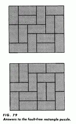

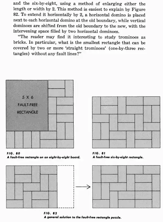

    Good. Note how the 2-D problem gets a good deal of help from rectangular fault-free tilings. A (fault-free) tiling for an $a$ by $b$ by $c$ brick might be random but still find use in constructing larger fault-free cubes. – Will Jagy Aug 08 '20 at 19:33
