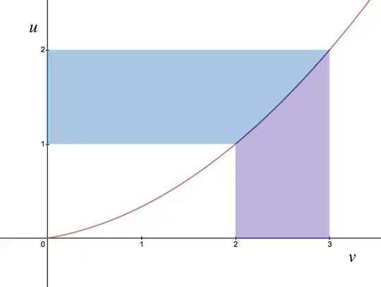

Note. Edited because Adayah pointed out (correctly, and to my chagrin) that this answer was totally sloppy—sloppier even than I intended it to be. Let's hope it's better now.
When we use integration by parts on an integral
$$ \int u(x) \, \mathrm{d}v(x) = \int u(x) v'(x) \, \mathrm{d}x $$
we implicitly treat $u$ and $v$ as parametric functions of $x$. If we plot these functions against each other on the $u$-$v$ plane, we might obtain something like the below:
(Note that $v$ is on the horizontal axis, and $u$ on the vertical.) In this diagram, the purple region below the curve represents the definite integral
$$ \int_{v(x)=2}^3 u(x) \, \mathrm{d}v(x) = \int_{x=v^{-1}(2)}^{v^{-1}(3)} u(x) v'(x) \, \mathrm{d}x $$
Similarly, the blue region to the left of the curve represents the definite integral
$$ \int_{u(x)=1}^2 v(x) \, \mathrm{d}u(x) = \int_{x=u^{-1}(1)}^{u^{-1}(2)} v(x) u'(x) \, \mathrm{d}x $$
Note that we can set
  • $x_1$ such that $u(x_1) = 1$ and $v(x_1) = 2$
  • $x_2$ such that $u(x_2) = 2$ and $v(x_2) = 3$
and so we can relate those two integrals by
$$ \int_{x=x_1}^{x_2} u(x) v'(x) \, \mathrm{d}x = \left. u(x) v(x) \phantom\int\!\!\!\!\! \right]_{x=x_1}^{x_2} - \int_{x=x_1}^{x^2} v(x) u'(x) \, \mathrm{d}x $$
Obviously this simple visualization of integration by parts relies (at least to some degree) on $u(x)$ and $v(x)$ being one-to-one; otherwise, we have to use signed areas. However, the necessary rigor can be added. I'm making the assumption that rigor was not what was needed here. (ETA: Though more than I provided at first!)

  • A sketch of how we address cases where it's not one-to-one: split the integration range at turning points, then handle each such range separately, multiplying $v$ by $-1$ on some if necessary to ensure it's increasing; this doesn't change whether $\int_a^buv^\prime dx=[uv]_a^b-\int_a^bvu^\prime dx$. – J.G. Jul 11 '20 at 10:23
  • That prompts a question then: let $g(x)=x$, explain the identity $$\int_a^b xf'(x) dx = \int_{f(a)}^{f(b)} f^{-1}(y) dy$$ – Ben Jul 11 '20 at 14:23
    @BrianTung I appreciate your professional response. After the correction I think this is a great answer which I can whole-heartedly upvote. – Adayah Jul 11 '20 at 19:19
  • This is interesting. In the limit, the diagram just illustrates the chain rule, but working with integrals instead allows it to be exact without any infinitesimals. – Carsten S Jul 12 '20 at 15:09
  • Hope this isn't too stupid, but why's there a dx just below the integral sign? Does it mean something? And that's $v(x_1)=3$, right? – harry Apr 04 '21 at 13:24
  • Sorry, meant $v(x_2)=3$ instead of what I wrote earlier. – harry Apr 04 '21 at 13:46
  • @harry: Oh yes, that's correct, I did mean $v(x_2) = 3$; thanks for the nice catch. As for the $dx$ below the integral sign, I don't see what you're referring to. Where is this? – Brian Tung Apr 10 '22 at 23:01
