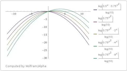

Sequence $\{a^n q^{n^2}\} = \{b^n\},\ $ where $\,\{b_n=aq^n\},\ $ converges to zero if and only if $|q|<1.$ If $aq>1,\ $ then it has increasing beginning part (see Wolfram Alpha plot for $q=3/4, a=1/2,1,2,4\ $ with the unit of the vertical axis in the decimal logarithms.).
Sequence q=3/4, a=1/2,1,2,4
The given series converges absolutely, if and only if $|q|<1.$

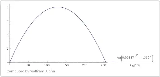

The worst case of summation is $aq^L = 1$ for the large values of $L.$ Then the greatest value of $M\approx a^nq^{n^2}$ achieves if $$\dfrac{a^{n+1}q^{(n+1)^2}}{a^nq^{n^2}} = 1, \quad n\approx \dfrac{-\log q}{2\log a}\approx\dfrac L2,\quad M\approx a^Lq^{L^2}\approx a^{\Large^L\!/\!_4},\quad a\approx \sqrt[\Large L]{M^4}.\tag4$$ If $a=1.335,\quad q=0.99887$, then $M\approx 10^8,\ L\approx 255.$
Plot a=1.335, q=0.99887
In this case, formula $(3)$ with $N=0$ gives $$S\approx 54764\,68327.05684,$$ and direct summation gives $$S = 54764\,683241.58768\dots$$
