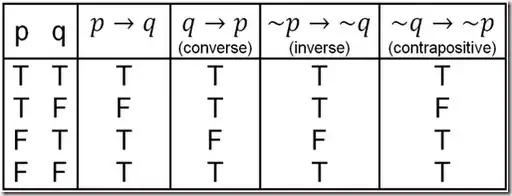

I have often seen truth tables similar to this one:
The first two rows, where $P$ is true, make sense to me. However, why does $P$ being true and $Q$ being false mean that $P \implies Q$?

The reason is that, in mathematics, "$P \implies Q$" is equivalent to "$Q$ or not $P$". Thus if $Q$ is true, $Q$ or not $P$ is also true, whatever $P$ is.
