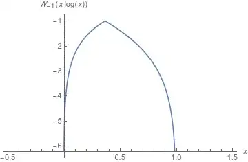

Let's look at $W_{-1}(x \ln x)$.
Mathematica graphics
The identity applies to the part to the left of the apex and not to the part to the right. You are interested in $x = 1/2$, which is to the right. (The apex is at the branch point of $W$, where $x \ln x = -1/\mathrm{e}$, i.e., where $x = 1/\mathrm{e}$. Since we are crossing the branch point, we should expect some kind of non-smoothness there.)
Ultimately, the answer to your question is just because $$ W_{-1} \left( \frac{1}{2} \ln \frac{1}{2} \right) = -2 \ln 2 \text{.} $$
