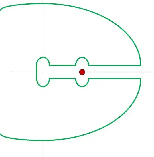

I've been trying to calculate $$\int_0^\infty\frac{1}{x^a(1-x)}\,dx\quad\text{with }0<a<1.$$I haven't had much luck. I tried taking the branch cut with of the positive reals and estimating that way, but I wasn't sure how to handle the poles at $z=0$ and $z=1$ when dealing with branch cuts. I also looked at the Wikipedia page to try to get some insight, but I didn't see any similar examples with the contour closing in on poles that are on a branch cut.

You use an almost-keyhole contour, except that you indent both paths above and below the real axis with a small semicircle to avoid the pole at $z=1$:
In doing this, you end up with not $4$, but $8$ contour segments. I will avoid writing them all out by noting that the integrals over the outer circular arc and inner circular arc at the origin vanish in the limits of their radii going to $\infty$ and $0$, respectively. We are left with
$$\oint_C dz \frac{z^{-a}}{1-z} = \int_{\epsilon}^{1-\epsilon} dx \frac{x^{-a}}{1-x} + i \epsilon \int_{\pi}^0 d\phi\, e^{i \phi} \frac{(1+\epsilon e^{i \phi})^{-a}}{-\epsilon e^{i \phi}} + \int_{1+\epsilon}^{\infty} dx \frac{x^{-a}}{1-x} \\+e^{-i 2 \pi a} \int_{\infty}^{1+\epsilon} dx \frac{x^{-a}}{1-x} +e^{-i 2 \pi a} i \epsilon \int_{2 \pi}^{\pi} d\phi\, e^{i \phi} \frac{(1+\epsilon e^{i \phi})^{-a}}{-\epsilon e^{i \phi}} +e^{-i 2 \pi a} \int_{1-\epsilon}^{\epsilon} dx \frac{x^{-a}}{1-x} $$
Combining like terms, we get
$$\oint_C dz \frac{z^{-a}}{1-z} = \left ( 1-e^{-i 2 \pi a}\right ) PV\int_{0}^{\infty} dx \frac{x^{-a}}{1-x} + \left ( 1+e^{-i 2 \pi a}\right ) i \pi = 0$$
because of Cauchy's Theorem. $PV$ denotes the Cauchy principal value. After a little algebra, the result is
$$PV\int_{0}^{\infty} dx \frac{x^{-a}}{1-x} = -i \pi \frac{1+e^{-i 2 \pi a}}{1-e^{-i 2 \pi a}}=-\pi \cot{\pi a}$$

- 141,538

No residue here, because we excluded the pole at $z=1$ from the interior of the contour. I would say that we just get contributions from the segments we use to avoid integrating over a pole. It is these contributions that give rise to the value of the integral we seek. This happens more often than you think, and mastery of this technique will provide you with a powerful tool. BTW the integral we sought is the Cauchy principal value because it avoids the pole on the real axis. – Ron Gordon Apr 26 '13 at 05:11
