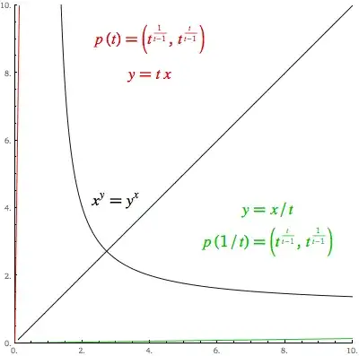

Here is where these points sit on the graph as $t\to1^+$:
where the points lie on the graph

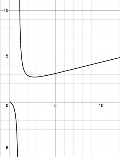

We are looking for solutions to $$ \exp(y\log x) = \exp(x\log y) \, . $$ Taking logs of both sides and rearranging, this equation becomes $$ \frac{x}{\log x}=\frac{y}{\log y} \, . $$ Consider the graph of $f(z)=z/\log z$:
z/log z
Its unusual shape can be explained by a few observations:
  • For $0<z<1$, $\log z$ is negative, so $f(z)$ is negative.
  • As $z\to1$, $\log z \to 0$, and so the graph has an asymptote at $z=1$.
  • For $z>1$, $\log z$ is positive, so $f(z)$ is positive.
  • $f(z)$ is large when $\log z$ is small, or when $z$ is very large.
It is the final observation that gives us a hint as to why $f(z)$ has a local minimum. We can study the behaviour of $f(z)$ more closely by considering $$ f'(z) = \frac{\log z - 1}{\log^2z} \, . $$ For $1<z<e$, $f'(z)$ is negative; at $z=e$, $f'(z)$ is zero; and for $z>e$, $f'(z)$ is positive.
Now that we have proven that $f(z)$ has a local minimum at $(e,e)$, we can begin to examine your question more closely. Let $(x,\log x)$ and $(y,\log y)$ be arbitrary points that lies on the graph.
  • Suppose $0<x<1$. Then, because $f(z)$ is one-to-one on the interval $(0,1)$, the only time when $f(x)=f(y)$ is when $x=y$.
  • If $x>1$, then things are more complicated. Clearly, if $x=y$, then we still have $f(x)=f(y)$. However, if $1<x<e$, then there is a unique number $y\in(e,\infty)$ such that $f(x)=f(y)$. This is obviously still the case if the roles of $x$ and $y$ are interchanged.
  • If $x$ is slightly smaller than $e$, then $y$ is either equal to $x$, or is only slightly larger than $e$. This means that the two sections of the graph get very close to each other as $x$ tends to $e$.
  • In the limit, when $x=e$, the two parts of the graph coincide.
