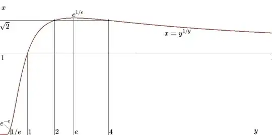

What seems to have been considered instead, however, is the inverse function of the tower:
y = x^{x^{.^{.^{.^.}}}} = x^y \quad \Longrightarrow \quad x = y^{1/y}
Scaling in $y$-direction is three times scaling in $x$-direction in the picture below, for good reasons.
While the power tower itself is not defined outside the interval $e^{-e} \le x \le e^{1/e}$, the inverse function, when considered apart from the former, is defined, not only for $\,1/e \le y \le e\,$ but for a much larger domain, namely $\,0 \le y \lt \infty\,$. Details of function behaviour are described a great deal in the following MSE posting and its references:
It's easy to prove that $\,\lim_{y\to\infty} y^{1/y} = 1\,$. This means that $\,x = y^{1/y}\,$ has twofold solutions $\,y_{1,2}\,$ for $\,1 \lt x \lt e^{1/e}\,$, one $\,1 \lt y_1 \lt e\,$ and the other $\,e \lt y_2\,$, wich is anyway clear from the picture. Indeed the OP's solutions are among these: $\,1 \lt 2\lt e \lt 4\,$.Numerically. Solutions of $\,y^{1/y}=x\,$ have been calculated by the (Delphi Pascal) program below. Values of $\,x\,$ are taken from a sample array, giving accompanying $\,y_{1,2}\,$ values with Newton's method. Initial $\,y_{1,2}\,$ are taken from previous steps, starting with the two known values from the question.

1.40000000000000E+0000 ==> ( 1.88666330624630E+0000, 4.41029279309327E+0000) 1.30000000000000E+0000 ==> ( 1.47098895928257E+0000, 7.85706535100170E+0000) 1.20000000000000E+0000 ==> ( 1.25773454121357E+0000, 1.47674583809828E+0001) 1.10000000000000E+0000 ==> ( 1.11178201104165E+0000, 3.82287327653121E+0001) 1.05000000000000E+0000 ==> ( 1.05270345488064E+0000, 9.28715283791938E+0001) 1.02000000000000E+0000 ==> ( 1.02041238660200E+0000, 2.85536314597273E+0002) 1.01000000000000E+0000 ==> ( 1.01010152374054E+0000, 6.51100334614211E+0002) 1.00100000000000E+0000 ==> ( 1.00100100150234E+0000, 9.12312634995737E+0003) 1.00010000000000E+0000 ==> ( 1.00010001000084E+0000, 1.16676997475209E+0005)It is seen that the $\,y_1\,$ values near $\,y=1\,$ are close to $\,x\,$. Which should not be surprising, because $1^{1/1}=1$ and $\,\left. dx/dy\right|_{y=1}=1\,$. But I have no decent estimate for the "far away" solutions $\,y_2\,$.
Han de Bruijn
- 17,475
By substituting $u=1/y$ the function $x=y^{1/y}$ is mapped onto $x=u^{-u}$. Which has a value $1$ for $u\to 0$ and a derivative $dx/du(u\to 0)\to\infty$. The latter is a measure for the error in the outcomes for $u\to 0;$ i.e. $y\to\infty$. This makes me think that there does not exist any decent approximation for the "far away" $y_2$ values. – Han de Bruijn Jul 01 '21 at 14:46
