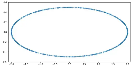

The problem with these approaches is that they are uniformly distributed with respect to theta, not along the surface. They are equivalent to taking a uniform distribution on a circle and then projecting about the radius to the perimeter of the ellipse, so the density of points is higher near the major axis, as you can see here:
(This is itself counterintuitive to me: One would expect the points to be denser about the minor axis since they are being "sprayed" over a more concentrated region, right?)

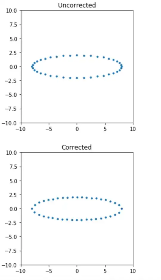

Some plots of the uncorrected and corrected ellipses are shown in the below figure, using the above derivation and code implementation below. I hope this helps.

Plot reference and transformed ellipses
x_axis_range=10 y_axis_range=10 plt.xlim(-x_axis_range, x_axis_range) plt.ylim(-y_axis_range, y_axis_range) plt.gca().set_aspect('equal', adjustable='box') plt.plot(ellip_x, ellip_y, '.') plt.title('Uncorrected') plt.show()
plt.xlim(-x_axis_range, x_axis_range) plt.ylim(-y_axis_range, y_axis_range) plt.gca().set_aspect('equal', adjustable='box') plt.plot(ellip_x_prime, ellip_y_prime, '.') plt.title('Corrected') plt.show() ```

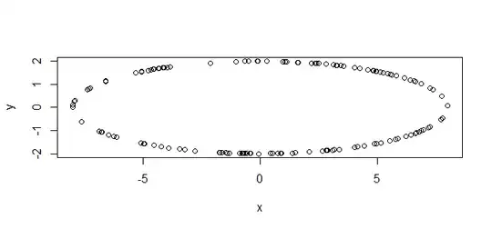

There may be an easier way: rejection sampling.
Building on ad2004's answer, which says
$$ \frac{{\mathrm{d}s}}{\mathrm{d}\theta}=\sqrt{a^{2}\sin^{2}{\theta}+b^{2}\cos^{2}{\theta}} $$ Now, the probability function is taken to be $$ p\left(\theta\right)=\frac{{\mathrm{d}s}}{\mathrm{d}\theta} $$ with the interpretation that when the rate-of-change of arclength increases, we want a higher probability of sample points in that interval to keep the density of points uniform.
we can simply accept sampled values of $\theta$ with probability proportional to $\frac{{\mathrm{d}s}}{\mathrm{d}\theta}$. Since $$\sqrt{a^{2}\sin^{2}{\theta}+b^{2}\cos^{2}{\theta}} \le \max(a,b),$$ we can use that bound as the denominator.
The following R code produces a sample. In this particular case and this seed with $a=8,b=2$ and $200$ initial samples, it accepts $146$ or almost three quarters of them.
a <- 8
b <- 2
set.seed(2025)
initialsample <- 200
theta <- runif(initialsample) * 2 * pi
OK <- runif(initialsample) < sqrt(a^2*sin(theta)^2 + b^2*cos(theta)^2) / max(a,b)
x <- a * cos(theta[OK])
y <- b * sin(theta[OK])
plot(x,y)
and the resulting sample looks plausible to me
sample from an ellipse
