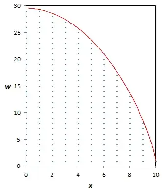

Essentially, we are trying to count the number of blue points under the red curve in the plot below (in this example, $z=100$). The equation for the curve is $w \log w = z-x^2$, and $z$ is assumed to be fixed.
The equation can be re-written as $w = (z-x^2)/W(z-x^2)$ where $W$ is the Lambert function, which behaves asymptotically like the $\log$ function. Thus the number of points below the red curve is asymptotically (for large values of $z$) equal to
$$r(z) \sim \int_0^\sqrt{z} \frac{z-x^2}{W(z-x^2)}dz \sim \int_0^\sqrt{z} \frac{z-x^2}{\log(z-x^2)}dz = \frac{1}{2}\int_0^z \frac{u}{\sqrt{z-u}\cdot\log u}du.$$

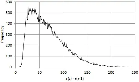

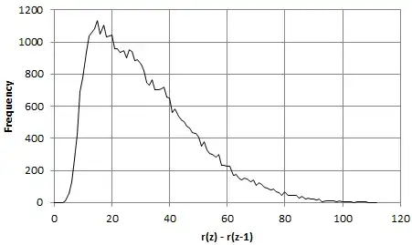

Below is a chart featuring the distribution for the number of solutions to $z=x^2+y$ [that is, the distribution of $r(z)-r(z-1)$] for $700000\leq z < 740000$. enter image description here
For instance, there are $441$ different $z$'s between $z = 700000$ and $z = 740000$ for which $z=x^2 + y$ has exactly $50$ solutions. Below is the same chart, but for $100000\leq z < 140000$. The two distributions are strikingly similar in shap2. enter image description here
