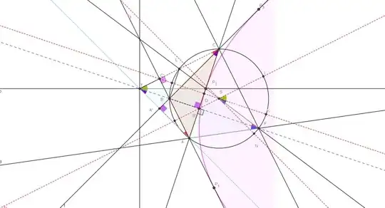

Since the points $P_1,P_2, P_3$ are close to the directrix, $\triangle ABC$ in my picture is obtuse and its orthocenter is outside the triangle, but it doesn't have to be so at all.
Let $A,B,C$ be the intersection points of the tangents. $P_2\in\overline{AC}$ due to $P_1\preceq P_2\preceq P_3$.
Let $A'\in\overline{BC}$ s.t. $AA'\perp BC$, $B'\in\overline{AC}$ s.t. $BB'\perp AC$ and $C'\in\overline{AB}$ s.t. $CC'\perp AB$.
The center $S$ of the circumscribed circle $q$ of $\triangle ABC$ is the intersection point of the bisectors $s_1,s_2,s_3$ of the sides $\overline{AB},\overline{BC}$ and $\overline{AC}$ respectively. Furthermore, $\underline{\text{each side bisector is parallel to one of the sides of the triangle}}$, i.e., $$s_1\parallel\overline{AA'}\ \&\ s_2\parallel\overline{BB'}\ \&\ s_3\parallel\overline{CC'} $$
If the orthocenter $T$ is an orthogonal projection of the point $P_2$ onto the directrix $x=-\frac{p}2$ of the parabola, and if the circumscribed circle $q$ really passes through the focus $$\boxed{F\left(\frac{p}2,0\right)\ \text{or}\ F\left(\frac{p}2+x_0,y_0\right)}$$ then $|TP_2|=|P_2F|$.

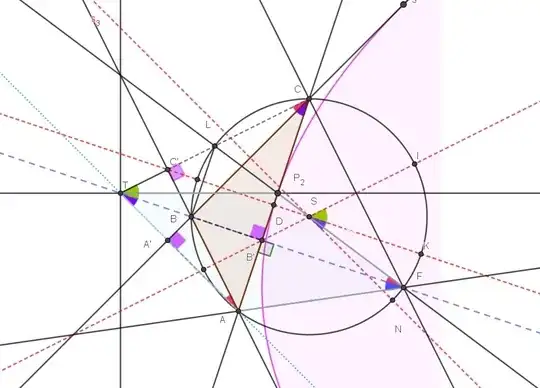

Picture: enter image description here
zoomed: zoomed just in case According to the notation in the picture: $$\begin{aligned}\measuredangle AA'B&=\measuredangle A'CT=\measuredangle BFL\\\measuredangle B'TA&=\measuredangle ACA'=\measuredangle AFB\end{aligned}$$ I can see: $$\triangle AB'T\sim\triangle BB'C\sim\triangle A'AC\sim AFB'$$ In particular: $\boxed{\triangle AB'T\cong\triangle AFB'\implies\ |TB'|=|B'F|\implies\triangle TFP_2\ \text{is isosceles}\ \implies |TP_2|=|P_2F|\ }$

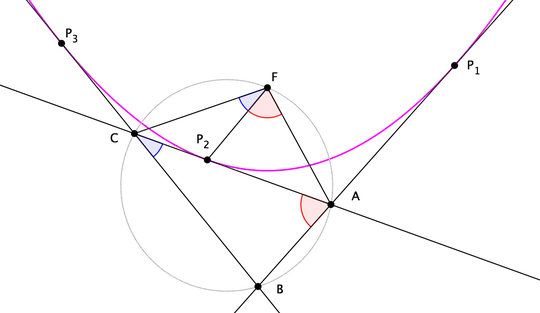

The second request easily follows from this theorem (see here for a proof):
The exterior angle between any two tangents is equal to the angle which either segment of tangent subtends at the focus.
It follows that $\angle CFP_2=\angle BCA$ and $\angle AFP_2=\angle CAB$, whence: $$ \angle CFA=\angle BCA+\angle CAB=\pi-\angle ABC. $$ Focus $F$ lies then on circle $ABC$.
