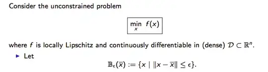

The following is what I am trying to do, i.e get a sample of the type $X_k$ as shown in the screenshots attached below: enter image description here enter image description here

  • @NateEldredge I attached a picture in the question, talking about a sample of this sort. I think this will help you understand it better, in case I might have missed something although I agree with what you are saying. Please look at this screenshots in terms of the sample $X_k$ as mentioned over there. There is also a set of points of differentiability $D$ of a chosen function $f(.)$ that is also considered. – halms Apr 23 '13 at 16:07
