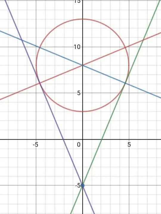

The equation of circle $C$ is $x^2 + (y − 8)^2 = 25$. The eye is located at $E = (0, −5)$. The maximal circular arc visible to the eye is $AB$, which is then being projected on to the one-dimensional "screen" as $A'B'$.
What are the co-ordinates of points $A$ and $B$?
I came this far: point $P$ on circle $C$ has the coordinates $x = 5 \cos\theta$, $y = 8 + 5 \sin \theta$. Now I should use this to find points $A$ and $B$, but I don't know how to proceed.

    The points $A$ and $B$ should be the points of tangency to the lines drawn from the point $(0,-5)$. So find the equation of the tangent lines drawn from this point and you can get the tangency points as well. – Anurag A May 18 '20 at 17:16
  • @AnuragA I'm still stuck and not sure how to solve it, would you be able to write it out? – John Hm May 18 '20 at 17:26
  • @AnuragA It’s much less work in general to compute the polar of the point and intersect that single line with the circle. The symmetry of the problem requires only one tangent line, if you’re going that route. – amd May 18 '20 at 18:14

I will use your parametric representation. Observe that the center of this circle is at $C(0,8)$. The distance $|CE|=8+5=13$. The $\triangle CAE$ is a right angled triangle with $|CA|=5$ (radius) and $|CE|=13$, so $EA=12$ (Pythagoras) (same will be true for $EB$).
Now $$|EA|=12 \implies \sqrt{(0-5 \cos \theta)^2+(-5-8-5\sin \theta)^2}=12.$$ This gives us $$194+130 \sin \theta=144. \implies \sin \theta=\frac{-5}{13}.$$ Thus we also get $\cos \theta=\pm \frac{12}{13}$.
So $A,B=(5 \cos \theta, 8+5\sin \theta)=\left(\pm \frac{60}{13}, \frac{79}{13}\right)$
Anurag A
  • 42,261
Note that $O(0,8)$ is the center, and EAO and EBO are right triangles with AB $\perp$ EO, giving
$$EA=EB= \sqrt{EO^2-r^2} =\sqrt{(8+5)^2 -5^2}=12$$
and $AB =2 \frac{ EA \cdot OA }{EO}= \frac{2\cdot 12\cdot 5}{13}=\frac{120}{13}$. So, let $A(\frac{60}{13},b)$, $B(-\frac{60}{13},b)$ and substitute them into $x^2+(y-8)^2=25$ to obtain $b=\frac{79}{13}$.
Thus, the endpoints are $(\pm \frac{60}{13},\frac{79}{13})$.

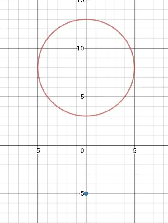

Let's first initialise parametric coordinates for the circle $x^2 + (y-8)^2 = 25$ as $P= (5 cos \theta , 8 + 5 \sin \theta )$
Let the given point be $Q(0,-5)$
circle and the point plotted
Then find slope of line segment PQ M($ \theta $)=$ \frac {13 + 5 \sin ( \theta)}{5 \cos ( \theta )}$ Which simplifies to$ \frac {13}{5} \sec( \theta ) + tan(\theta)$
