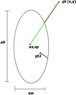

Assuming I have an ellipse with known center position (ex,ey) and size (ew,eh), how can I calculate the distance from x,y to the edge of the ellipse (in straight line from center)?
i.e. red line in the following image.
Note that the point can also be inside the ellipse (blue line).

    "Edge of ellipse" is ambiguous. Do you want the intersection of a straight line to the point and the ellipse, or instead the closest point on the ellipse? – David G. Stork May 12 '20 at 00:42
  • Sorry, I mean the intersection of a straight line to the point and the ellipse center. – user1495024 May 12 '20 at 00:44
  • The set up and solve the simultaneous equations. – David G. Stork May 12 '20 at 00:52

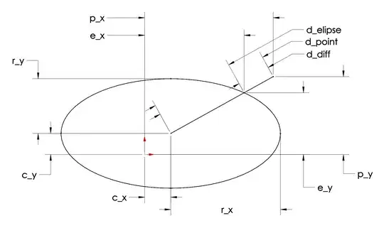

TLDR: In the situation pictured below
ellipse variable names
$d_{diff} = \sqrt{ (p_x-c_x)^2 + (p_y-c_y)^2 } - \sqrt{\frac{r_x^2 \times r_y^2 \times ((p_x-c_x)^2 + (p_y-c_y)^2)}{(p_x-c_x)^2 \times r_y^2 + (p_y-c_y)^2 \times r_x^2}}$
or, in the case that the ellipse is centered at the origin ($c_x = 0$ and $c_y = 0$)
$d_{diff} = \sqrt{ p_x^2 + p_y^2 } - \sqrt{\frac{r_x^2 \times r_y^2 \times (p_x^2 + p_y^2)}{p_x^2 \times r_y^2 + p_y^2 \times r_x^2}}$
Be warned that this is not the shortest distance from the point to the edge of the ellipse. Still, the value being calculated here is important in certain situations.
---THE REMAINDER IS THE BORING DERIVATION STUFF---
equation 1: $\frac{p_x-c_x}{p_y-c_y} = \frac{e_x-c_x}{e_y-c_y}$ (The points lie on the same line)
equation 2: $\frac{(e_x-c_x)^2}{r_x^2} + \frac{(e_y-c_y)^2}{r_y^2} = 1$ (equation of an elipse)
equation 3: $d_{point} = \sqrt{(p_x-c_x)^2 + (p_y-c_y)^2}$ (distance between two points)
equation 4: $d_{ellipse} = \sqrt{(e_x-c_x)^2 + (e_y-c_y)^2}$ (distance between two points)
equation 5: $d_{diff} = d_{point} - d_{ellipse}$
  1. Solving for $e_y-c_y$ with equation 1: $e_y-c_y = \frac{(p_y-c_y) \times (e_x-c_x)}{p_x-c_x}$
  2. Solving for $e_x-c_x$ by substituting line 1 into equation 2: $e_x-c_x = (p_x-c_x) \times r_x \times r_y \times \sqrt{\frac{1}{(p_x-c_x)^2 \times r_y^2 + (p_y-c_y)^2 \times r_x^2}}$
  3. Solving for $e_y-c_y$ by substituting line 2 into equation 1: $e_y-c_y = (p_y-c_y) \times r_x \times r_y \times \sqrt{\frac{1}{(p_x-c_x)^2 \times r_y^2 + (p_y-c_y)^2 \times r_x^2}}$
  4. Solving for $d_{ellipse}$ by substituting lines 2 and 3 into equation 4: $d_{ellipse} = \sqrt{\frac{r_x^2 \times r_y^2 \times ((p_x-c_x)^2 + (p_y-c_y)^2)}{(p_x-c_x)^2 \times r_y^2 + (p_y-c_y)^2 \times r_x^2}}$
  5. Solving for $d_{diff}$ by substituting line 4 into equation 5: $d_{diff} = \sqrt{(p_x-c_x)^2 + (p_y-c_y)^2} - \sqrt{\frac{r_x^2 \times r_y^2 \times ((p_x-c_x)^2 + (p_y-c_y)^2)}{(p_x-c_x)^2 \times r_y^2 + (p_y-c_y)^2 \times r_x^2}}$
---NOTES---
I tried generating some values and solutions for this problem in some CAD software, checked them against substituting $cos(\theta) = \frac{x}{\sqrt{x^2+y^2}}$ and $sin(\theta) = \frac{y}{\sqrt{x^2+y^2}}$ into user765629's equation and it did not produce the correct answer. I did the same for the equation I produced and it produced the correct answer.
