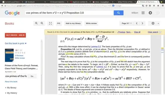

Well, he is correct, there is an isomorphism with the group of equivalence classes of positive binary forms of discriminant $-199,$ under Gauss composition...
The easiest way is to find equivalent forms which all have the same middle term, so that Dirichlet's description of Gauss composition is evident. In this case, forcing the middle coefficient to be $43$ works nicely. Each triple $\langle a,b,c \rangle$ refers to the binary form $$ f(x,y) = a x^2 + b xy + c y^2. $$
From Henri Cohen, A Course in Computational Number Theory, especially pages 225-229: we have Theorem 5.2.8, when $D<0$ is congruent to $0$ or $1 \pmod 4,$ we have a mapping from the positive forms (well, eqivalence classes) of that discriminant $$ \langle a,b,c \rangle \; \; \mapsto \; \; \; a \mathbb Z + \frac{-b + \sqrt D}{2} \mathbb Z $$ Lehman's notation is different. Also, for real fields and indefinite forms the mapping is usually two to one; it's a long story.
The first form is the group identity, the second is a group generator. $$ \langle 1, 43, 512 \rangle $$ $$ \langle 2, 43, 256 \rangle $$ $$ \langle 4, 43, 128 \rangle $$ $$ \langle 8, 43, 64 \rangle $$ $$ \langle 16, 43, 32 \rangle $$ $$ \langle 32, 43, 16 \rangle $$ $$ \langle 64, 43, 8 \rangle $$ $$ \langle 128, 43, 4 \rangle $$ $$ \langle 256, 43, 2 \rangle $$
Indeed, Dirichlet's method gives $$ \langle 2, 43, 2^8 \rangle \circ \langle 2^k, 43, 2^{9-k} \rangle = \langle 2^{k+1}, 43, 2^{8-k} \rangle $$
