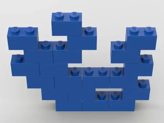

One of the most surprising combinatorial formulas I know of counts the number of LEGO towers built from $n$ "$1 \times 2$" blocks subject to four rules:
  1. The bricks lie in a single plane.
  2. Each brick is offset by 1 stud (as in a brick wall).
  3. The bottom layer is contiguous.
  4. Each brick has at least one brick below it (apart from the bottom layer).
Example
Example of a
Formula

While writing up a short essay on this fact, I became interested in what happens when you relax some of the rules.
In particular, for the small values I checked on the computer, removing the second rule ("Each brick is offset by 1 stud") appears to result in $4^{n-1}$ towers with $n$ bricks.
I imagine this result exists in the literature, and I was hoping MSE could help me find it. If it hasn't been written down anywhere, I was hoping for insight for how to adapt Bóna's proof into this new setting.
Peter Kagey
  • 5,438
16
Your result $4^{n-1}$ is correct. Bóna's proof goes through with a single modification. In the last step that counts the half-pyramids, there is one more option: A bottom brick with a half-pyramid on it whose bottom brick is directly on top of the bottom brick.
Instead of $H\cong(H\times\bullet\times H)+(\bullet\times H)+\bullet$ we get $H\cong(H\times\bullet\times H)+(\bullet\times H)+(\bullet\times H)+\bullet$, thus $H=xH^2+2xH+x$, and then
\begin{eqnarray} P &=& \frac H{(1-H)^2} \\ &=& \frac H{-2H + (1+H^2)} \\ &=& \frac H{-2H + H\frac{1-2x}x} \\ &=& \frac x{1-4x}\;. \end{eqnarray}
