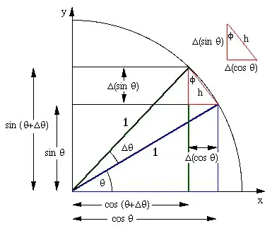

Every time I look for "intuitive" explanations of why trig derivatives and integrals are what they are, I always get graphics like the following:
However, Sines and Cosines show up in mathematical topics which aren't always geometric by nature...even if perhaps connections to triangles and circles can always be found.
Are there ways to explain, still intuitively (by intuitive I mean explanations that "click," I don't mean hand-wavy...I hope that makes sense), but non-geometrically, why the derivative of sine is cosine (and why the integral of cosine is sine, derivative of cosine is -sine, etc...)?

It comes down to how you choose to define sine and cosine. There are multiple possible definitions, which are not obviously equivalent, but all give rise to the same functions and therefore can all be used to intuit $\frac{d}{dx} \sin(x) = \cos(x)$ and $\frac{d}{dx} \cos(x) = -\sin(x)$. I'll go through the three most common definitions:
Geometric definition:
If you're working with the geometric definitions for sine and cosine, then the geometric proof for their derivatives is clearly the most intuitive. Whether or not it is intuitive to you is a function of your intuition for geometry and calculus, not the sine and cosine functions specifically.
