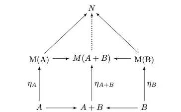

Consider the following diagram, where $A,B$ are sets, $A+B$ is their disjoint union, and $M(X)$ is the free monoid on $X$ for $X=A, B, A+B$. I want to prove that $M(A+B)$ is the coproduct of $M(A)$ and $M(B)$, just using universal properties. How does the universal properties of $A+B, M(A), M(B)$ and $M(A+B)$ induce the existence (and uniquiness) of the dotted vertical arrow to $N$? In other words, how can I prove that $M(A+B)$ has the universal property of the coproduct $M(A)+M(B)$ of $M(A)$ and $M(B)$, without invoking any concrete presentation of the objects involved, such as the free monoid of words,...?

  • Does this line of reasoning work for you? Let $a:M(A)\to N$ and $b:M(B)\to N$ be the two slanted arrows at the top. We have $a\circ\eta_A: A\to N$ and $b\circ\eta_B:B\to N$. By universality of coproduct in the set category, $a$ and $b$ uniquely induce $\gamma:A\sqcup B\to N$. Hence, by universality of free objects in the monoid category, we have a unique morphism $c:M(A\sqcup B)\to N$ through which $\gamma$ factors. It remains to show that $c$ makes the diagram commutative. – Batominovski Apr 24 '20 at 16:01
  • @Batominovski yes, but following that reasoning I come up with an equality of composites I would like to cancel on the right to get the wanted commutativity of diagrams, but I can't cancel on the right because the morphisms on the right are monic, don't know what I am missing – Maryam Apr 24 '20 at 16:02
    Now that you mentioned this, I start to think that knowing the properties of free monoids may play a role. If I figure something out, I'll let you know. – Batominovski Apr 24 '20 at 16:10

The ingredients required for this proof are
  • the functions $\eta_A:A\to M(A)$, $\eta_B:B\to M(B)$, and $\eta_{A\sqcup B}:A\sqcup B\to M(A\sqcup B)$;
  • the functions $i_A:A\to A\sqcup B$ and $i_B:B\to A\sqcup B$;
  • the monoid morphisms $a:M(A)\to N$ and $b:M(B)\to N$.
Other maps will be constructed through the universal properties in the relevant categories. (I am not comfortable using the notation $A+B$ for the coproduct of two sets $A$ and $B$. In my notation, $A\sqcup B$ is the coproduct.) The same proof works if $\mathbf{Monoids}$ is replaced by any concrete category that admits all free objects and coproducts (or at least, that the sets $A$, $B$, and $A\sqcup B$ are bases of some free objects $M(A)$, $M(B)$, and $M(A\sqcup B)$ in the target category).
We have two functions $a\circ\eta_A: A\to N$ and $b\circ\eta_B:B\to N$. By the universality of coproduct in $\mathbf{Sets}$, $a$ and $b$ uniquely induce $\gamma:A\sqcup B\to N$. That is, $$a\circ\eta_A = \gamma\circ i_A\text{ and }b\circ\eta_B=\gamma\circ i_B\,.$$
By the universality of free objects in $\mathbf{Monoids}$, we have a unique monoid morphism $c:M(A\sqcup B)\to N$ through which $\gamma$ factors. In other words, $$\gamma=c\circ\eta_{A\sqcup B}\,.$$ It remains to show that $c$ makes the diagram commutative.
We have a function $\eta_{A\sqcup B}\circ i_A:A\to M(A\sqcup B)$, which induces a unique monoid morphism $\iota_A:M(A)\to M(A\sqcup B)$ by the universality of free objects in $\mathbf{Monoids}$. That is, $$\iota_A\circ \eta_A=\eta_{A\sqcup B}\circ i_A\,.$$ Similarly, we have a unique monoid morphism $\iota_B:M(B)\to M(A\sqcup B)$. Likewise, $$\iota_B\circ \eta_B=\eta_{A\sqcup B}\circ i_B\,.$$
Consequently, $$(c\circ \eta_{A\sqcup B})\circ i_A=c\circ\left(\eta_{A\sqcup B}\circ i_A\right)=c\circ (\iota_A\circ\eta_A)=(c\circ \iota_A)\circ \eta_A\,.$$ However, $$(c\circ \eta_{A\sqcup B})\circ i_A=\gamma\circ i_A=a\circ \eta_A\,.$$ Thus, $\eta_A$ is an equilizer of the diagram $$A\underset{\eta_A}{\to} M(A)\underset{a}{\overset{c\circ \iota_A}{\rightrightarrows}}N\,.$$ Using the universality of free objects in $\mathbf{Monoids}$, we conclude that $$c\circ\iota_A=a\,.$$ Similarly, $$c\circ\iota_B=b\,.$$ Therefore, $M(A\sqcup B)$ together with $\iota_A:M(A)\to M(A\sqcup B)$ and $\iota_B:M(B)\to M(A\sqcup B)$ is the coproduct of $M(A)$ and $M(B)$.

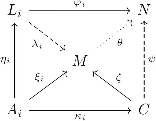

Let $(A_i)_{i \in I}$ be a family of sets with a coproduct $C.$ Let $(\kappa_i \colon A_i \to C)_{i \in I}$ be the family of functions with the appropriate universal property. For all $i \in I,$ let there be given a monoid $L_i$ that is free over $A_i.$ Let $(\eta_i \colon A_i \to L_i)_{i \in I}$ be the family of functions with the appropriate universal property. Let $M$ be a monoid that is free over $C.$ Let $\zeta \colon C \to M$ be the function with the appropriate universal property. For all $i \in I,$ define $\xi_i = \zeta \circ \kappa_i \colon A_i \to M.$
We wish to show that $M$ is a coproduct of the family of monoids $(L_i)_{i \in I}.$ That is, there exists a family of homomorphisms $(\lambda_i \colon L_i \to M)_{i \in I}$ with the universal property that for every monoid $N$ and every family of homomorphisms $(\varphi_i \colon L_i \to N)_{i \in I}$ there exists a unique homomorphism $\theta \colon M \to N$ making the upper triangle in this diagram commute:
For all $i \in I,$ because $L_i$ is free over $A_i,$ there exists a unique homomorphism $\lambda_i \colon L_i \to M$ that makes the left hand triangle in the diagram commute. This defines the family $(\lambda_i \colon L_i \to M)_{i \in I}$ that is needed for the coproduct.
Because $C$ is a coproduct of the $A_i,$ there exists a unique function $\psi \colon C \to N$ that makes the square in the diagram commute, for all $i \in I.$ Because $M$ is free over $C,$ there exists a unique homomorphism $\theta \colon M \to N$ that makes the right hand triangle in the diagram commute. Then, for all $i \in I$: $$ (\theta \circ \lambda_i) \circ \eta_i = \theta \circ (\lambda_i \circ \eta_i) = \theta \circ \xi_i = \theta \circ (\zeta \circ \kappa_i) = (\theta \circ \zeta) \circ \kappa_i = \psi \circ \kappa_i = \varphi_i \circ \eta_i. $$ By the uniqueness clause of the universal property of $L_i$ as a free monoid over $A_i,$ it follows that $\theta \circ \lambda_i = \varphi_i.$ It only remains to show that $\theta$ with this property is unique. If $\theta \circ \lambda_i = \varphi_i,$ then: $$ (\theta \circ \zeta) \circ \kappa_i = \theta \circ (\zeta \circ \kappa_i) = \theta \circ \xi_i = \theta \circ (\lambda_i \circ \eta_i) = (\theta \circ \lambda_i) \circ \eta_i = \varphi_i \circ \eta_i = \psi \circ \kappa_i. $$ If this holds for all $i \in I,$ then $\theta \circ \zeta = \psi,$ by the uniqueness clause of the universal property of $C$ as a coproduct of the $A_i.$ The required result now follows from the uniqueness clause of the universal property of $M$ as a free monoid over $C.$
