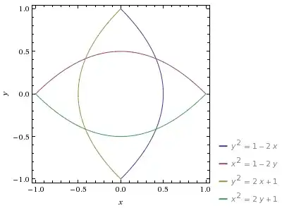

Your thought process looks good, but the integration is actually a bit tricky. Here is your dartboard:

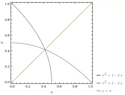

We'd like to calculate the area of the center shape, and as you say, we can split this into eight slices of equal area. Here we see the two slices in the first quadrant:
Let's compute the area of the slice from $45^{\circ}$ to $90^{\circ}$:
$$\int_{0}^{\sqrt{2}-1}(\frac{1-x^2}{2}-x)dx=\frac{1}{6}(4\sqrt{2}-5)$$
Multiplying this by $8$ gives us the area of the center shape. Then, we divide by $4$, the area of the dartboard. The final probability is then:
$$\frac{1}{3}(4\sqrt{2}-5)\approx.2190$$
Judging by our picture above, this seems right. The center shape is about $1/5$ the area of the dartboard.
