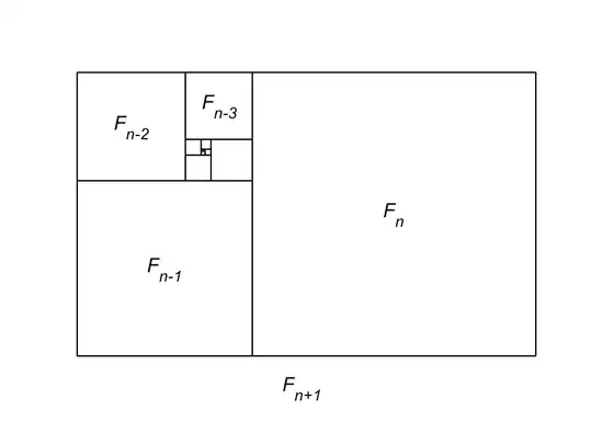

This identity is readily proved from the Fibonacci mosaic, as seen in the image below $$\sum_{i=1}^{n} F_i^2 = F_nF_{n+1}$$
Fibonacci mosaic identity
