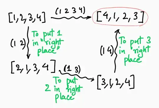

The results follow naturally upon considering the action of $ S_n $ on arrangements :
A list $ [k_1, \ldots, k_n] $ made by taking $ 1, 2, \ldots, n $ in some order is called an arrangement.
For $ \sigma \in S_n $ and arrangement $ [k_1, \ldots, k_n] $, we can define
$$ \sigma * [k_1, \ldots, k_n] := ( [k_1, \ldots, k_n] \text{ after putting each } k_i \text{ into slot } \sigma(i) )$$
That is, $ [k_1, \ldots, k_n] \rightsquigarrow \sigma * [k_1, \ldots, k_n] $ amounts to putting whatever is in slot $ i $ into slot $ \sigma(i) $.
Note $\sigma * [k_1, \ldots, k_n] = [k_{\sigma^{-1} (1)}, \ldots, k_{\sigma^{-1} (n)}]$
[Because in $ [k_1, \ldots, k_n] \rightsquigarrow \sigma * [k_1, \ldots, k_n] $ the $ k_t $ which gets sent to slot $ j $ satisfies $ \sigma(t) = j $ i.e. $ t = \sigma ^{-1} (j) $.]
Also $ \sigma * ( \tau * [k_1, \ldots, k_n] ) = (\sigma \tau) * [k_1, \ldots, k_n] $
[Because in $[k_1, \ldots, k_n] \rightsquigarrow \sigma * (\tau * [k_1, \ldots, k_n])$, $k_i$ is first sent to slot $ \tau(i) $ and then to slot $ \sigma(\tau(i)) $. And $ [k_1, \ldots, k_n] \rightsquigarrow (\sigma \tau)*[k_1, \ldots, k_n] $ has the same effect.]
We'll write $ ``\, [k_1, \ldots, k_n] \stackrel{\sigma}{\rightsquigarrow} [l_1, \ldots, l_n]"$ to mean $`` \, [l_1, \ldots, l_n] = \sigma * [k_1, \ldots, k_n]" $.
Example 1. Cycle $ (1 \, \, 2 \, \, 3 \, \, 4) = (1 \, \, 4) (1 \, \, 3) (1 \, \, 2) $. It's easy to check this is true, but here is one way we can come up with the decomposition :
So $$ (1 \, \, 2 \, \, 3 \, \, 4)*[1,2,3,4] = (1 \, \, 4)*\bigg( (1 \, \, 3) * ( (1 \, \, 2) * [1,2,3,4]) \bigg)$$
i.e.
$$(1 \, \, 2 \, \, 3 \, \, 4)*[1,2,3,4] = (1 \, \, 4) (1 \, \, 3) (1 \, \, 2) * [1,2,3,4] $$
i.e.
$$ (1 \, \, 2 \, \, 3 \, \, 4) = (1 \, \, 4) (1 \, \, 3) (1 \, \, 2) $$
This suggests in general $ (a_1 \, \, a_2 \, \, \ldots \, \, a_k) = (a_1 \, \, a_k) (a_1 \, \, a_{k-1}) \ldots (a_1 \, \, a_2) $, which is readily verified to be true.

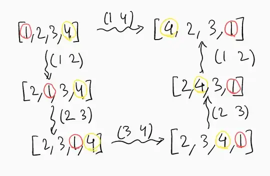

Example 2.
So
$$ (1 \, \, 4) = (1 \, \, 2) (2 \, \, 3) (3 \, \, 4) (2 \, \, 3) (1 \, \, 2) $$
Similarly in general any transposition is a product of an odd number of "elementary transpositions" [i.e. transpositions of the form $ (j \, \, j+1) $]
