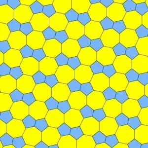

There is a tiling of the plane made from regular heptagons and irregular pentagons.
We know that regular heptagons cannot tile the plane.
The irregular pentagon has four equal sides and one shorter side. A tiling of the plane by these pentagons would require two pentagons to share the short side (as they do in the image), but the resulting angle cannot then be tiled by other pentagons, so this irregular pentagon does not tile the plane.
Image via: https://twitter.com/gregegansf/status/1003181379469758464
I think the reference is to this paper: https://erikdemaine.org/papers/Sliceform_Symmetry/paper.pdf
nickgard
  • 4,266
  • Wouah, it seems so cool! I love this beautiful example! I'll have a closer look and then accept your answer. – Alphonse Apr 06 '20 at 08:07
    The hexagon-pentagon tiling shown in the paper (p. 207) has a more interesting symmetry, it's not as simple, regular and not obviously periodic. He calls it 'almost-regular'. Wonder why there are different arrangements. Maybe one is a near miss. –  Apr 06 '20 at 17:06
    One detail perhaps worth pointing out, though it's kind of obvious in hindsight, is that the argument that any "tiling of the plane by these pentagons would require two pentagons to share the short side" involves the fact that all corners of the pentagon are obtuse, and thus it's not possible for the corners of two (or more) pentagons to meet in the middle of an edge of a third pentagon (as e.g. in this tiling). – Ilmari Karonen Apr 07 '20 at 02:56
