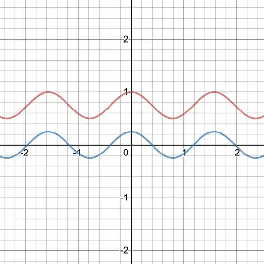

I graphed $x\mapsto \sin^4 x + \cos^4 x$ and $x \mapsto \frac{1}{4}\cos4x$ on the same axes, and here's what I saw.
graph of two functions.  one graph is a vertical shift of the other:
You have to remember that for a constant $k$, we have that $\frac{d}{dx} (k) =0$. Hence when we integrate a function in different ways, we may obtain functions which differ by a constant. Differentiating once more will see you obtain the same function.
