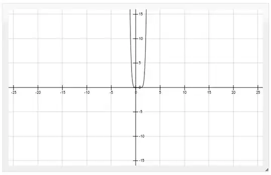

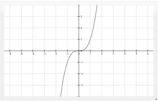

$x^3$ has a point of inflection at $x=0$. How will you modify the formula to add a 2nd point of inflection at $x=1$?
Plot of $x^3$ enter image description here
Plot of $x^3(x-1)^3$ enter image description here

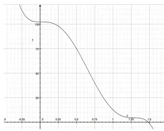

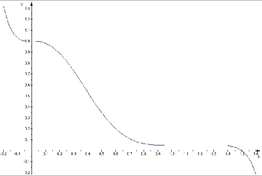

The plot I am aiming to achieve has a shape similar to the graph below. However I would like the 2 inflection points at $(0, 1)$ and $(1, 0.05)$, and intersects the x-axis at $(1.5,0)$ and y-axis at $(0,1)$.
Graph with similar target shape enter image description here

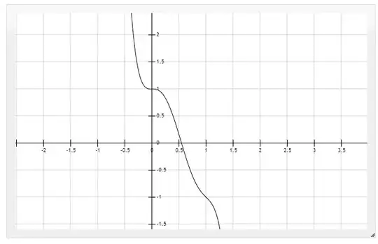

Current attempt
The closest I can get is using $1 - [ 16x^3 - 23x^4 + 9x^5 ]$ using J.M.'s equation inside the $[]$ square brackets with $\alpha=2$ and $\beta=1$. How should I bring the point of inflection at $x=1$ up to around $y=0.05$? Its currently at $y=-1$

  • But your second diagram seems to have a point of inflection at $x=1.25$, not $x=1$. – TonyK Apr 13 '13 at 20:18
  • I just saw your update. Are you trying to get the equation of the second graph? Meaning two inflections points at $(0,105)$ and $(1.25,5)$? Or just any equation with two inflections, one along $x = 0$ and another along $x = 1$? – Jerry Apr 13 '13 at 20:19
  • @TonyK I would like a point of inflection at 1 instead. Will it be easy to adjust the point of inflection between $x=1$ to $x=1.25$? – Nyxynyx Apr 13 '13 at 20:27
  • @Jerry Sorry for the confusion, I've updated the question to make it clearer. I'm looking to get inflection points $(0, 1)$ and $(1, 0.05)$, and intersects the x-axis at $(1.5,0)$ and y-axis at $(0,1)$ – Nyxynyx Apr 13 '13 at 20:32

It seems that there is an implicit constraint (because else George V. Williams' answer (+1) would be perfect !) : that the derivatives at $x=0$ and $1$ are $0$ !
With these constraints I got a polynomial of degree $6$ $P(x)=\frac{706}{135}x^6-\frac{385}{18}x^5+\frac{5389}{180}x^4-\frac{3977}{270}x^3+1$
but the behavior was not nice near $\frac 32$ so that I tried again with a polynomial of degree $7$ and the additional constraint $P'\left(\frac 32\right)=-1$ (change this if wished !) : $$P(x)=a x^7+b x^6+c x^5+dx^4+ex^3+fx^2+gx+h$$ From $P(0)=1$ we get $\ h=1$
From $P(1)=\frac 1{20}$ we get $\ a+b+c+d+e+f+g=\frac 1{20}-1$
We want too $P\left(\frac 32\right)=0$ but will write this down later...
$$P'(x)=7ax^6+6b x^5+5c x^4+4dx^3+3ex^2+2fx+g$$ Should $P'(0)=P'(1)=0$ be wished then $g=0\ $ and $\ 7a+6b+5c+4d+3e+2f=0$
(we will impose too $P'\left(\frac 32\right)=-1$ at the end) $$P''(x)=42ax^5+30b x^4+20c x^3+12dx^2+6ex+2f$$
From $P''(0)=P''(1)=0$ we get $f=0\ $ and $\ 7a+5b+\frac {10}3c+2d+e=0$
Let's put everything together (the two last lines from the array concern $64P'\left(\frac 32\right)$ and $128P\left(\frac 32\right)$) : $$P(x)=a x^7+bx^6+c x^5+dx^4+ex^3+1$$ with \begin{array}{cccccc} a &+b &+c &+d &+e&= &-\frac{19}{20}\\ 7a &+6b &+5c &+4d &+3e &= &0\\ 7a &+5b &+\frac {10}3c&+2d&+e&=&0\\ 5103a &+ 2916b &+ 1620c &+ 864d &+ 432e &=&-64\\ 2187a &+ 1458 b &+ 972 c &+ 648d &+ 432e &=&-128\\ \end{array}
The solution deduced from this system is : $$P(x)=-\frac{838}{135}x^7+\frac{4477}{135}x^6-\frac{1223}{18}x^5+\frac{34603}{540}x^4-\frac{6491}{270}x^3+1$$
with the picture : polynomial of degree 7

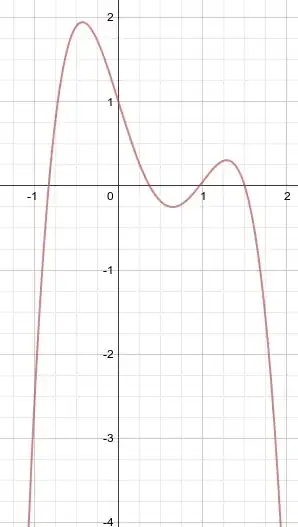

Use a fourth-degree polynomial $f(x) = ax^4 + bx^3 + cx^2 + dx + e$, and get that:
$$ f''(x) = 12ax^2 + 6bx + c = 0 \text{ at } x = 0 \text{ and } 1$$
So we get that:
$$ c = 0 \text{ and } 12a + 6b = 0$$
Well that's still not enough! Based on what you said, we also know that $e = 1$ (since $f(0) = 1$). We also need that:
$$f(1) = a+b+c+d+e = \\ a + b + d + 1 = 0.05$$
So close, and your last criterion, that $f(1.5) = 0$, will let us finish it:
$$ 5.0625 a + 3.375 b + 1.5d + 1 = 0$$
We have the following system of equations:
$$ 2a + b = 0 \\ a + b + d + 1 = 0.05 \\ 5.0625 a + 3.375 b + 1.5d + 1 = 0 $$
Solving the system of equations, we get:
$$a = -\frac{34}{15} \\ b = \frac{68}{15} \\ d = -\frac{193}{60} $$
Graphing the result:
image graph
