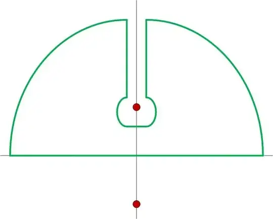

Maybe this is going to seem a lot more involved than it needs to be, but it is likely that complex methods are not the best way to attack an integral like this. Nonetheless, it is possible.
We consider the integral in the complex plane
$$\oint_C dz \frac{\log{(1+z^2)}}{1+z^2}$$
where $C$ is some contour to be determined. Our first instinct is to make $C$ a simple semicircle in the upper half plane. The problem is that the branch point singularity at $z=i$ is extremely problematic, as it coincides with an ostensible pole. Nonetheless, the corresponding integral over the real line is finite (and twice the originally specified integral), so there must be a way to treat this.
The way to go with branch points like this is to avoid them. We thus have to draw $C$ so as to do that, and then use Cauchy's theorem to state that the above complex integral about $C$ is zero. Such a contour $C$ is illustrated below.
imagbranch
The contour integral is then taken along six different segments. I will state without proof that the integral about the two outer arcs vanishes as the radius of those arcs $R \to \infty$. We are then left with four integrals:
$$\int_{-R}^R dx \frac{\log{(1+x^2)}}{1+x^2} + \left [\int_{C_-}+\int_{C_+}+\int_{C_{\epsilon}} \right ] dz \frac{\log{(1+z^2)}}{1+z^2} = 0$$
$C_-$ is the segment to the right of the imaginary axis, down from the arc to the branch point, $C_+$ is the segment to the left of the imaginary axis, up from the branch point to the arc, and $C_{\epsilon}$ is the circle about the branch point of radius $\epsilon$.
It is crucial that we get the arguments of the log correct along each path. I note that the segment $C_-$ is "below" the imaginary axis and I assign the phase of this segment to be $2 \pi$, while I assign the phase of the segment $C_+$ to be $0$.
For the segment $C_-$, set $z=i(1+y e^{i 2 \pi})$:
$$\int_{C_-} dz \frac{\log{(1+z^2)}}{1+z^2} = i\int_R^{\epsilon} dy \frac{\log{[-y (2+y)]}+ i 2 \pi}{-y (2+y)} $$
For the segment $C_+$, set $z=i(1+y)$:
$$\int_{C_-} dz \frac{\log{(1+z^2)}}{1+z^2} = i\int_{\epsilon}^R dy \frac{\log{[-y (2+y)]}}{-y (2+y)} $$
I note that the sum of the integrals along $C_-$ and $C_+$ is
$$-2 \pi \int_{\epsilon}^R \frac{dy}{y (2+y)} = -\pi \left [ \log{R} - \log{(2 + R)} - \log{\epsilon} + \log{(2 + \epsilon)}\right]$$
For the segment $C_{\epsilon}$, set $z=i (1+\epsilon e^{-i \phi})$. The integral along this segment is
$$\begin{align}\int_{C_{\epsilon}} dz \frac{\log{(1+z^2)}}{1+z^2} &= \epsilon \int_{-2 \pi}^0 d\phi e^{-i \phi} \frac{\log{\left [ -2 \epsilon e^{-i \phi} \right]}}{-2 \epsilon e^{-i \phi}}\end{align}$$
Here we use $\log{(-1)}=-i \pi$ and the above integral becomes
$$\begin{align}\int_{C_{\epsilon}} dz \frac{\log{(1+z^2)}}{1+z^2} &= -\frac12 (-i \pi)(2 \pi) - \frac12 \log{2} (2 \pi) - \frac12 \log{\epsilon} (2 \pi) -\frac12 (-i) \frac12 (0-4 \pi^2) \\ &= -\pi \log{2} - \pi \log{\epsilon} \end{align}$$
Adding the above integrals, we have
$$\begin{align}\int_{-R}^R dx \frac{\log{(1+x^2)}}{1+x^2} -\pi \log{R} + \pi \log{(2 + R)} + \pi \log{\epsilon} - \pi \log{(2 + \epsilon)} -\pi \log{2} - \pi \log{\epsilon} &= 0\\ \implies \int_{-R}^R dx \frac{\log{(1+x^2)}}{1+x^2} -\pi \log{R} + \pi \log{(2 + R)} - \pi \log{(2 + \epsilon)} -\pi \log{2} &=0\end{align}$$
Now we take the limit as $R \to \infty$ and $\epsilon \to 0$ and we get
$$\int_{-\infty}^{\infty} dx \frac{\log{(1+x^2)}}{1+x^2} -2 \pi \log{2} = 0$$
Therefore
$$\int_{0}^{\infty} dx \frac{\log{(1+x^2)}}{1+x^2} = \pi \log{2}$$

  • @EricNaslund: many thanks. – Ron Gordon Apr 24 '13 at 14:42
    (+1) Finally solution with contuor integration, like OP wanted (I suppose). – Cortizol Apr 27 '13 at 08:26
  • @Ron You directed me to your post, so I hope you're willing to answer some of my questions. I don't think the branch of $\log(1+z^{2})$ you used coincides with that cut. I'm pretty sure that cut is the result of using the principal branch of $\log(1+z^{2})$. And when I parametrized the contour around the branch point at $z=i$, I assumed I could replace $(i+\epsilon e^{it})^{2}$ with $-1 + 2i\epsilon e^{it}$ since we're only interested in small values of $\epsilon$. You seem to have done something similar but without stating what you did. Could you elaborate? – Random Variable Aug 27 '13 at 15:05
  • The branch of the log doesn't coincide with what cut? And I did exactly what you said, see the integral about $C_{\epsilon}$. It is certainly there - we are just making sure we are picking up the contribution from the branch point. – Ron Gordon Aug 27 '13 at 15:13
  • I assume we want the branch cuts on the imaginary axis from $i$ to $i \infty$ and from $-i$ to $-i \infty$. Along those cuts $1+z^{2}$ is negative and real. So those cuts come about by choosing the principal branch of $\log(1+z^{2})$. So the argument of $\ln(1+z^{2})$ just to the right of the cut on $[i, i \infty)$ is $\pi$, while just to the left of the cut the argument is $- \pi$. – Random Variable Aug 27 '13 at 15:27
  • That is correct, but it makes no difference. In general, once you get comfortable with this, you know to replace the log with a jump of $i 2 \pi$. – Ron Gordon Aug 27 '13 at 15:29
  • I know. But it could matter in other situations using other functions. And finally how can we be certain that we will still pick up the contribution from the branch point after making that simplification? – Random Variable Aug 27 '13 at 15:40
  • I agree that I should have gotten the phase right, and really, great catch. It matters when we are dealing with higher powers of log. For integrals linear in log, only the phase difference matters, so the mistake escaped my scrutiny. – Ron Gordon Aug 27 '13 at 15:43
  • @RonGordon How does the integral over the two outer arcs vanish? I don't think this is very straightforward. – Incognito Mar 28 '14 at 18:09
  • @user108149: depends on what you mean by straightforward. I think it is; just sub $z=R e^{i \theta}$ and note that the integral over each arc is bounded by $$\frac{\pi}{2} \frac{\log{R}}{R}$$ which certainly goes to zero. See for yourself. – Ron Gordon Mar 28 '14 at 18:25
  • @RonGordon How is it bounded by that term? If anything, I'd say that it's bounded by $\frac{\log(R^2+1)}{R^2-1}$, and I'm not really sure how to deal with that logarithm. – Incognito Mar 28 '14 at 18:28
