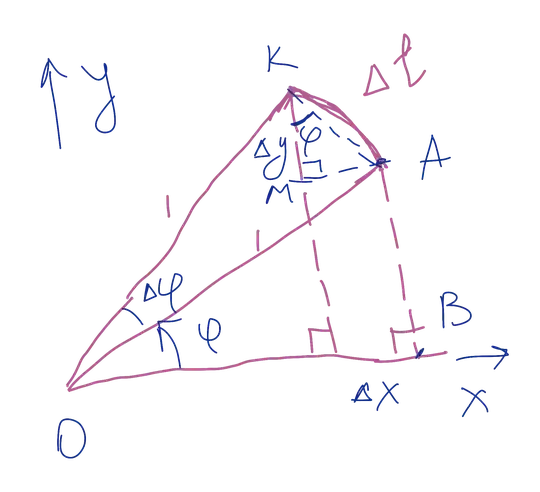

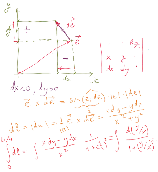

I came up with 3 basic ways but none of them is easy, each of them involves some geometry. But universally there have to be built some trigonometry around, otherwise at integration/differentiation there would be misunderstanding of arcsin/arctan functions. Also $\lim\frac{\sin x}{x}$ have to be built somehow, and geometry is best suited for it.
