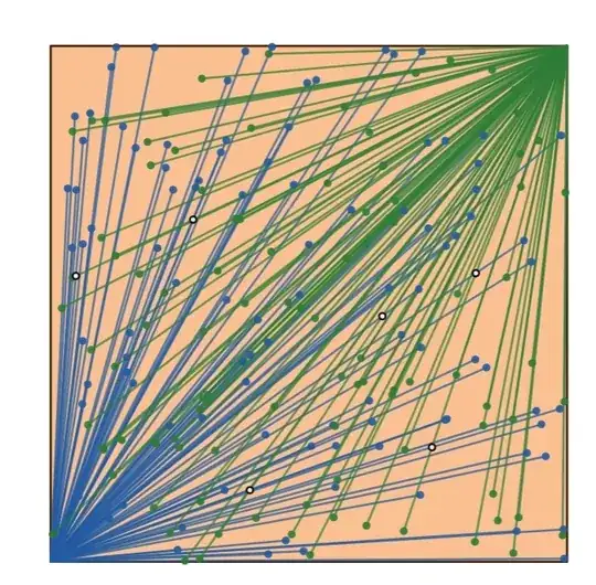

"In a square with side length 1, two random points in the square are connected by segments to two opposite vertices. How likely is it that the two segments will intersect?"
Diagram of a square with 100 pairs of random points selected, connected and the intersections noted as white circles. There are 6 intersections in this trial.
Steve Phelps, who posted this problem, uses desmos to solve it by experimentation. Here is his notebook.
He gets a very low probability about of about .09. But, I'd like the algebraic result.

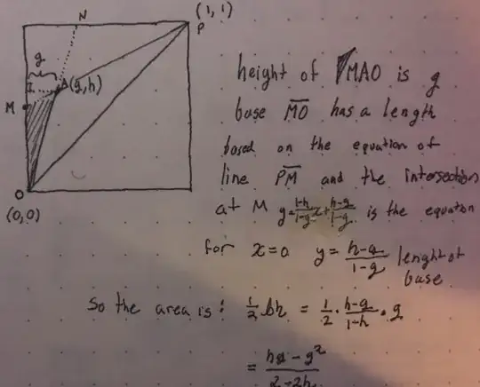

I've reduced the problem to the following:
Diagram on notebook paper of a 1x1 square and the triangular region where point B must be place for an intersection with the line segment connected to A to occur. (given both points are on the same side of the diagonal connecting the vertices of the square connected to points A and B.)
WLOG we can consider the case where both of the randomly chosen points are on the same side of the diagonal formed by connecting the vertices we will connect to the random points. If we consider a random point A, then BP will intersect AO if B is in the shaded region.
What is the average area for that region if we pick a random point?

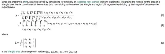

Still I'd like to work this out. I think I can use this formula:
Screen cap of formula on the page: http://mathworld.wolfram.com/TriangleTrianglePicking.html
With vertices: (0,0), (1,0), (0,1)
I don't know how to fix the vertices of the randomly picked triangle at $\left(0, \frac{h-g}{1-g}\right)$, (0,0) and (h,g) using this formula. So, maybe another approach is needed?

$\renewcommand{\dd}[1]{\,\mathrm{d}#1}$Following your own diagram, due to symmetry it suffices to consider the region above the diagonal $h>g$ then multiply by two.
$$\text{Pr} = \text{area of shaded triangle} = 2 \int_{h=0}^1 \int_{g=0}^h \frac12 g \frac{h-g}{1-g}\dd{g}\dd{h} = \frac1{12}$$ where the integrand is the triangle with height $g$ and base width $\frac{h-g}{1-g}$. (There's a "typo" in the bottom two lines of the transcript: the denominator is $1-g$, not $1-h$)
In case one doesn't know how to do this integral, here's Wolfram Alpha code Integrate[g(h-g)/(1-g),{h,0,1},{g,0,h}].
  • I'm a little confused since g < h why are the limits of the inner integral from g=h to g=1 and not g=0 to g=h? The answer is the same, so I think it's just the area of the triangle reflected in y=x, the diagonal. – futurebird Feb 03 '20 at 14:07
  • Sorry that was a typo. I was using a different set of variables before switching to yours. – Lee David Chung Lin Feb 03 '20 at 14:08
