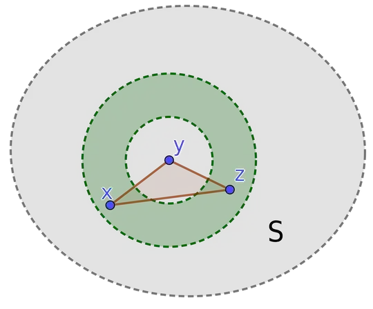

Choose $\epsilon > 0$ so that $S$ contains a ball of radius $3\epsilon$. Let $V$ be the set of all triples $(x, y, z) \in S^3$ satisfying the following conditions:
  • $\operatorname{dist}(y, \partial S) > 2\epsilon$,
  • $\epsilon < \operatorname{dist}(x, y) < 2\epsilon$, and
  • $\epsilon < \operatorname{dist}(y, z) < 2\epsilon$.
These conditions imply that $x$ and $z$ lie inside an annulus centered at $y$, with inner radius $\epsilon$ and outer radius $2\epsilon$, entirely contained in $S$. See Figure 1. Figure 1. A triple (x, y, z) in V.
By continuity of the distance function, $V$ is a nonempty open subset of $S^3$.

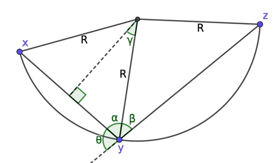

Observe that $V$ has continuous rotational symmetry. The point $z$ can be rotated about the point $y$, keeping both $x$ and $y$ fixed. In symbols, the map $r_{\theta}\colon V\to V$ is an isometry for each $\theta \in [0, 2\pi)$, where $$ r_{\theta}(x, y, z) = (x, y, y + (z - y) e^{i\theta}). $$ This implies that the measure of the angle $xyz$ is uniformly distributed on $[0, \pi]$ when $(x, y, z)$ is drawn from $V$.
Let $(x, y, z) \in V$, and let $\theta = \pi - m(\angle xyz)$, as shown in Figure 2. We may assume without loss of generality that $\operatorname{dist}(x, y) \le \operatorname{dist}(y, z)$. Since $\alpha \ge \beta$, $\theta + \alpha + \beta = \pi$, and $\alpha + \gamma = \pi/2$, it follows that $\gamma \le \theta/2$. Therefore, $$ R = \frac{\operatorname{dist}(x, y)}{2\sin \gamma} > \frac{\epsilon}{2 \sin(\theta/2)} > \frac{\epsilon}{\theta}. $$
Figure 2. The circle passing through x, y, and z.
But $\theta$ is uniformly distributed on $[0, \pi]$. Therefore, $$ \operatorname{E}[R\,|\,V] \ge \frac{1}{\pi} \int_0^{\pi} \frac{\epsilon}{\theta}\, d\theta = \infty. $$
