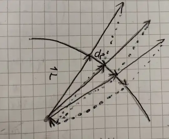

I understand geometrically why
$$\vec{A} = \dfrac{1}{2}\oint \vec{r} \times d\vec{s} \;\;\text{where A is the enclosed area}$$
is true: If you draw an arbitrary closed loop and draw the position vector with the line element you get parallelograms of which you can "flip" half of it out in order to add the next part and so on.
Picture of my explanation concerning the geometric understanding
But I do not know how to show this rigeriously and did not find much on the internet, especially because I do not know what to google for exactly. I know that we had something similar in my first year of university in electromagnetism, but we gave no proof for it to be true.
