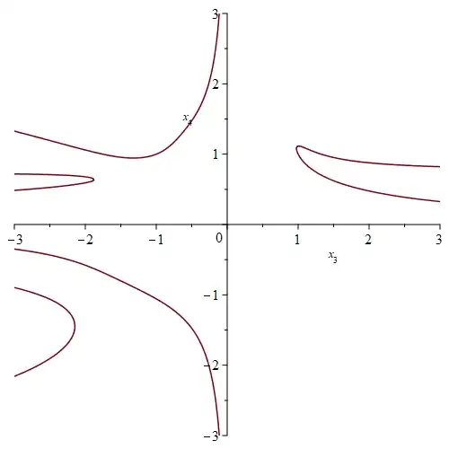

Or if instead you eliminate $\alpha$, you get a curve in $x_3$ and $x_4$ that looks like this:
