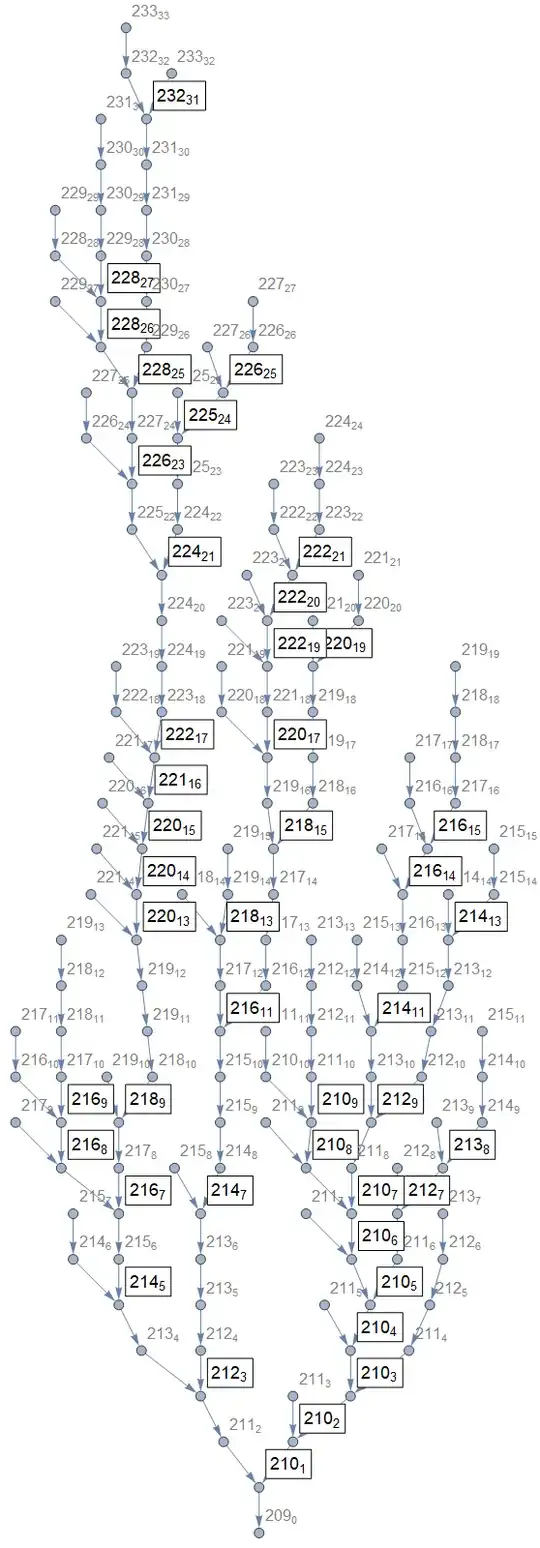

Update: Just a quicky. I got to thinking about Arnaud's note about reverse engineering, and I've got an idea to float. I tried doing some mapping of the origin possibilities for various $b_0$, and while the primes are nice and robust, the composites are not. The very best they have to offer in the first 500 or so is probably:
graph
which makes sense, what with $209$ being a larger semiprime and $233$ up top being one half of a problem semiprime that shows up a bit.
I had hoped that that possibility graphs for the primes could be infinite, but if my code is right, it turns out they're merely far larger than the non-primes. Here's a sample:
\begin{array}{|l|l|l|l|} \hline \mathbf{b_0} & & \textbf{nodes} & \textbf{max length} \\ \hline 101 & 101 & 6206 & 818 \\ \hline 102 & 2\cdot 3\cdot 17 & 1 & 0 \\ \hline 103 & 103 & 9779 & 918 \\ \hline 104 & 2^3\cdot 13 & 1 & 0 \\ \hline 105 & 3\cdot 5\cdot 7 & 4 & 2 \\ \hline 106 & 2\cdot 53 & 1 & 0 \\ \hline 107 & 107 & 11059 & 1074 \\ \hline 108 & 2^2\cdot 3^3 & 1 & 0 \\ \hline 109 & 109 & 6293 & 1094 \\ \hline 110 & 2\cdot 5\cdot 11 & 1 & 0 \\ \hline 111 & 3\cdot 37 & 4 & 2 \\ \hline 112 & 2^4\cdot 7 & 1 & 0 \\ \hline 113 & 113 & 8886 & 1184 \\ \hline 114 & 2\cdot 3\cdot 19 & 1 & 0 \\ \hline 115 & 5\cdot 23 & 8 & 4 \\ \hline 116 & 2^2\cdot 29 & 1 & 0 \\ \hline 117 & 3^2\cdot 13 & 4 & 2 \\ \hline 118 & 2\cdot 59 & 1 & 0 \\ \hline 119 & 7\cdot 17 & 44 & 14 \\ \hline 120 & 2^3\cdot 3\cdot 5 & 1 & 0 \\ \hline 121 & 11^2 & 70 & 22 \\ \hline 122 & 2\cdot 61 & 1 & 0 \\ \hline 123 & 3\cdot 41 & 4 & 2 \\ \hline 124 & 2^2\cdot 31 & 1 & 0 \\ \hline 125 & 5^3 & 20 & 8 \\ \hline 126 & 2\cdot 3^2\cdot 7 & 1 & 0 \\ \hline 127 & 127 & 12230 & 1268 \\ \hline \end{array}
I also analyzed some parameters from the first $15000$ non-prime graphs. There are a few strong correlations, particularly that between large semiprimes and larger graphs, but the most promising find is what looks like a strong bound on the ratio of total nodes in the graph to $b_0$. It was $<1$ always, and looked to be decreasing, suggesting a strong bound might be possible. (This same ratio was $>1$ for all primes, and scaled very close to linearly.)
Since the maximum length (or height if you like) of the graph is the critical piece that determines whether or not this whole conjecture works, and since that length is a subset of the total graph, a hard limit on the number of nodes would effectively be a proof that the conjecture holds up.
To be clear, "nodes" correspond to starting pairs of numbers which would lead to a given $b_0$. The pair of numbers in question are the ones we previously called $n$ and $2n$, but we're being more flexible now. So, if it turned out there were some compelling reason why any given composite $m$ must have less than $m$ different starting pairs that led to its being $b_0$, that would be sufficient for a proof.

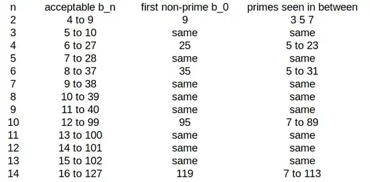

Conjecture 1: $b_0$ is the smallest prime larger than $n$.
Conjecture 2: $b_0$ is always a prime number as soon as $b_n$ is greater than $n+1$ and lower than some increasing bound. For a fixed $n$, all those prime values of $b_0$ make up a set of consecutive primes.

The table below shows the range of $b_n$ values for which $b_0$ is a prime. Blockquote
