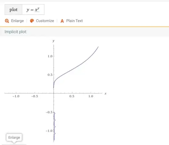

The explicit solution of $y=x^y$ is given in terms of Lambert function $$y=-\frac{W(-\log (x))}{\log (x)}$$ and, in the real domain, it is bounded at $x=e^{\frac{1}{e}}$.
Naman Jain's answer gives the plot of it.
