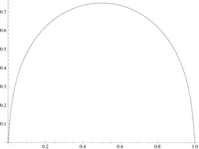

Maximize $\displaystyle\int_0^a\pi y^2\,\mathrm{d}x$ while maintaining $\displaystyle\int_0^a\sqrt{1+y'^2}\,\mathrm{d}x=2a$. In other words:
find the $y$ so that $$ \int_0^a y\,\delta y\,\,\mathrm{d}x=0\tag{1} $$ for every $\delta y$ so that $$ \int_0^a\frac{y'\,\delta y'}{\sqrt{1+y'^2}}\,\mathrm{d}x=0\tag{2} $$ Integrating $(2)$ by parts gives $$ \int_0^a\frac{y''}{\left(1+y'^2\right)^{3/2}}\,\delta y\,\mathrm{d}x=0\tag{3} $$ $(1)$ and $(3)$ imply that there is a constant $b$ so that $$ -\frac{y''}{\left(1+y'^2\right)^{3/2}}=2b^2y\tag{4} $$ $(4)$ describes the critical $y$:
$\hspace{3.5cm}$enter image description here
Multiply $(4)$ by $y'$, integrate, and solve for $y'$ $$ (1+y'^2)^{-1/2}=b^2y^2+c^2\\[6pt] y'=\pm\sqrt{\frac1{(b^2y^2+c^2)^2}-1}\tag{5} $$ Since $y''$ is always one sign, it must be negative. Thus, $y'$ is positive until $y$ reaches maximum, then it is negative until $y=0$.
The length of the curve is $$ \begin{align} &2\int_0^{\frac{\sqrt{1-c^2}}{b}}\sqrt{1+y'^2}\frac{\mathrm{dy}}{y'}\\ &=2\int_0^{\frac{\sqrt{1-c^2}}{b}}\frac{\mathrm{d}y}{\sqrt{1-(b^2y^2+c^2)^2}}\\[6pt] &=\frac{2\sqrt{1-c^2}}b\int_0^1\frac{\mathrm{d}y}{\sqrt{1-((1-c^2)y^2+c^2)^2}}\\ &=\frac2{b\sqrt{c^2+1}}\mathrm{EllipticK}\left(\frac{c^2-1}{c^2+1}\right)\tag{6} \end{align} $$ The width of the curve (distance between $x$-intercepts) is $$ \begin{align} &2\int_0^{\frac{\sqrt{1-c^2}}{b}}\frac{\mathrm{dy}}{y'}\\ &=2\int_0^{\frac{\sqrt{1-c^2}}{b}}\frac{(b^2y^2+c^2)\,\mathrm{d}y}{\sqrt{1-(b^2y^2+c^2)^2}}\\[6pt] &=\frac{2\sqrt{1-c^2}}b\int_0^1\frac{((1-c^2)y^2+c^2)\,\mathrm{d}y}{\sqrt{1-((1-c^2)y^2+c^2)^2}}\\ &=\frac2{b\sqrt{c^2+1}}\left((c^2+1)\mathrm{EllipticE}\left(\frac{c^2-1}{c^2+1}\right)-\mathrm{EllipticK}\left(\frac{c^2-1}{c^2+1}\right)\right) \tag{7} \end{align} $$ Solving for the $c$ that makes $(6)$ the double of $(7)$ yields $$ c=0.26829153853907013879\tag{8} $$ For that $c$, $(7)$ gives the width of the curve to be $$ a=\frac1b1.29027749675509851046\tag{9} $$ Equations $(4)$ and $(5)$ say that $y$ increases from $0$ to its maximum and returns to $0$ symmetrically. Thus, $y(a/2)$ is the maximum of $y$. Equation $(5)$ says that $y'=0$ when $$ y=\frac{\sqrt{1-c^2}}{b}\tag{10} $$ Answer: Therefore, combining $(8)$, $(9)$, and $(10)$ yields $$ y(a/2)=0.74661285489041830537\,a\tag{11} $$
Volume: Since we are maximizing the volume, why not compute the volume: $$ \begin{align} &2\int_0^{\frac{\sqrt{1-c^2}}{b}}\pi y^2\frac{\mathrm{dy}}{y'}\\ &=2\pi\int_0^{\frac{\sqrt{1-c^2}}{b}}\frac{y^2(b^2y^2+c^2)\,\mathrm{d}y}{\sqrt{1-(b^2y^2+c^2)^2}}\\[6pt] &=2\pi\left(\frac{\sqrt{1-c^2}}b\right)^3\int_0^1\frac{y^2((1-c^2)y^2+c^2)\,\mathrm{d}y}{\sqrt{1-((1-c^2)y^2+c^2)^2}}\\ &=\frac{2\pi\sqrt{c^2+1}}{3b^3}\left(\mathrm{EllipticK}\left(\frac{c^2-1}{c^2+1}\right)-c^2\mathrm{EllipticE}\left(\frac{c^2-1}{c^2+1}\right)\right) \tag{12} \end{align} $$ Combining $(8)$, $(9)$, and $(12)$ gives $$ \text{Volume}=1.21275710583444588043\,a^3 $$

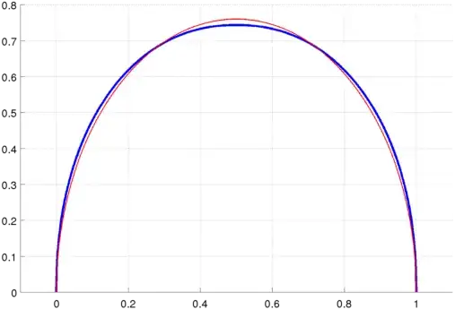

Numerical approach: After some furious trial and error for different functions satisfying the E-L equations for problem $(\dagger)$ and $(\ddagger)$, I am suggesting (as of now), a closed-form solution is impossible. So we turn to some numerical approach setting $a = 1$, $l=2$. Equi-distant sample points are: $(x_n,y_n)$, with $0\leq n\leq N+1$, step size $h$, $(x_0,y_0) = (0,0)$, and $(x_N,y_N) = (1,0)$.
Volume's approximation $V_h$ can be found by $$ V_h = \sum^{N}_{n=0}\pi h\frac{(y_n +y_{n+1})^2}{4} = \mathbf{y}^T A\mathbf{y}, $$ with $\mathbf{y} = (y_1,\ldots,y_n)$, and $A$ is a tri-diagonal matrix $$ A =\frac{\pi h}{4}\begin{pmatrix} 2 & 1 & & 0\\ 1 & \ddots & \ddots & \\ & \ddots & \ddots & 1 \\ 0 & & 1 & 2 \end{pmatrix}, $$ The arclength constraint is: $$ S_h = \sum^{N}_{n=0} \sqrt{(y_{n+1}-y_n)^2 + h^2} = 2. $$ This is a very hard nonlinear quadratic programming problem. Using $101\times 101$ grid points on $[0,1]^2$ (step size $h=10^{-2}$), $y(1/2)\approx 0.74$, blue curve is the curve maximizing the revoluted volume, while the red curve is a scaled circle that has the same arclength ($\mathrm{error}<O(10^{-2})$)
curve
In computing the approximation, I found that the amount of work looking for all curves that satisfies the constraint is insanely large which is $O(2^{100})$! So here I admit I cheated the big way by assuming the following:
  • The curve achives maximum at $x=1/2$, non-descreasing from $x=0$ to $x=1/2$, and is symmetric about $x=1/2$.
Hence now the problem turns into a pure integer programming, we want to find the increment step vectors for the first half $(v_1,\ldots,v_{N/2})$, with each entry non-negative. The curve's $y$-coordinates can be then written as the following with a lower-triangular matrix $B$:
$$ \begin{pmatrix}y_1\\ \vdots \\y_{N/2} \end{pmatrix} =h\begin{pmatrix} 1 & 0 & 0& 0\\ 1 & 1 & \ddots & 0\\ 1& \ddots & 1 & 0 \\ 1 &1 & 1 & 1 \end{pmatrix}\begin{pmatrix}v_1\\ \vdots \\v_{N/2} \end{pmatrix}. $$ Let $v = (v_1,\ldots,v_{N/2},v_{N/2},\ldots,v_1)^T$, then $$ y = \begin{pmatrix}B & 0\\ E & -B \end{pmatrix}v = Cv, $$ where $E$ is a matrix with all its entries being $1$. Notice the boundary condition is already incorporated for we consider only the increment (we can set $v_0 = 0$), now the problem changes to:
$$\text{Maximize } V_h[v]= v^T C^T ACv \\ \text{subject to } v_n \geq 0, \sum^{N/2}_{n=1} v_n \leq N,\;\text{and } S_h[v] = \sum^{N/2}_{n=0} 2h\sqrt{ v_n^2 + 1} = 2. \tag{$\star$}$$
In real simulation, I used Monte Carlo for $(\star)$ (I am not an expert in nonlinear optimization, there should be a more state-of-art approach rather than this brute force approach). The numerical procedures roughly are:
  1. Generating an enormous amount of random numbers in scaled Dirichlet distribution for integer (non-negative numbers with sum fixed) with a fixed sum from $N-1,N-2,\ldots, N/2$. This fixed sum is the total number of steps $y$ goes up in the grids from $x=0$ to $x=1/2$. Notice $N/2$ is the highest number of increment steps in a perfect circle, for the arclength is $2>\pi/2$ so we wanna at least choose increment step more than that heuristically, unless there exists some zig-zag curves that maximize the volume (zig-zag won't pass the arclength constraint though).
  2. Checking which increment step vectors are satisfying the arclength constraint within certain relative error $\epsilon$ (I chose $0.05$ in simulation).
  3. Compute the volume then choose the maximum one.
  4. Decreasing the $\epsilon$ for the arclength, perturb the increment step vector, repeat.
The eventual $y(1/2)= h\sum_{n=1}^{N/2} v_n$ for that maximizer increment step vector. What I got was $$ y(1/2)\approx 0.74, \text{ with } V[y] \approx 1.212108. $$

    Your plot looks like the plot of the differential equation in my answer. Did you get a value for $y(a/2)$? – robjohn Jul 03 '13 at 05:55
  • I agree that there may be no closed form solution for $y$, but given the constants of integration involved in getting the differential equations for $y$, there is a closed form in terms of elliptic functions for the length and the width of the curve. – robjohn Jul 03 '13 at 06:02
  • @robjohn I got $y(1/2)\approx 0.74$, the grid points were $100\times 100$ on $[0,1]^2$, so the error was at least $O(10^{-2})$, I am glad this brute force solution agrees with your answer. – Shuhao Cao Jul 03 '13 at 12:27
  • This is quite an impressive numerical approach. I imagine you could simply refine the mesh and get more precision. (+1) – robjohn Jul 03 '13 at 13:38
  • @robjohn Thanks. About being more precise...Hmmm, I used Monte Carlo, and I am not an expert in numerical nonlinear optimization. $100\times 100$ grid size has already a huge amount of computation...(I felt guilty for borrowing dept's server doing this...) Please see my edit for my approach (Wasn't so confident yesterday for I cheated by assuming I know what the shape is gonna be like at first). – Shuhao Cao Jul 03 '13 at 16:16
  • The differential equations ($(4)$ and $(5)$ in my answer) confirm your assumption about the location of the maximum and the symmetry. – robjohn Jul 04 '13 at 00:54
