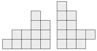

I was thinking that something based on counting the length of the sides could work. For example, the following polyomino:
has one 5-length side, two 2-length sides and five 1-length sides. So we could describe it with the following notation: $\{(5,1),(2,2),(1,5)\}\,$, where the first number in parenthesis stands for the length of the side and the second one for the number of sides of that length. Then, all translations, rotations, reflections or glide reflections of this shape would result in the same description. Which is good.

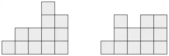

However, this doesn't work in general. For example, the following two different polyominoes:
would result in the same description $\{(5,1), (3,1), (2,2), (1,6) \}$.

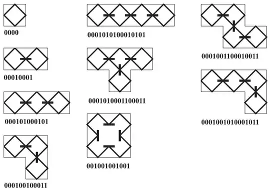

Thanks for the useful suggestions in the comments. After some more research I found an interesting method, explained in the book "Linknot: Knot Theory by Computer - S. Jablan, R. Sazdanovic", which works like this:
Let's imagine the path of a ray of light (bold line in figure) in a polyomino with the borders consisting of mirrors, where in every border cell we place two-sided mirrors (bolder lines) perpendicular to the internal edges in their midpoints . After a series of reflections, the ray of light will describe a shape called self-avoiding curve. If we denote a reflection in a border mirror by 0, and a reflection in an internal mirror by 1, we have 0-1 words for polyominoes, where these words are cyclically equivalent (this means, could be red starting from any sign 0 or 1 and ending in it). For n = 1 we will have only one polyomino 0000, for n = 2 the polyomino 00010001, for n = 3 two polyominoes: 000101000101 and 000100100011, for n = 4 five of them: 0001010100010101, 0001010001100011, 001001001001, 0001001100010011, and 0001001010001011, etc.
We can translate these symbols (or binary numbers) into hexadecimal numbers and assign one number to each polyomino, in order to establish one-to-one correspondence between the numbers and polyominoes. For example, this number can be the minimum of all cyclic-equivalent symbols (e.g. to the polyomino 00010001 correspond cyclically equivalent symbols 00100010, 01000100, 10001000 and the minimum of them is 00010001 = 11 in the hexadecimal system). Hence, we have a notation for polyominoes where exactly one number corresponds to every polyomino, and vice versa.
This last part of the method is similar to what achille hui was suggesting in his "dumb" method, in the comments. I don't know how the efficiency of this approach compares to the efficiency of the "dumb" one, but I think it should be faster, since we are only considering the "perimeter" of the polyomino and forgetting about the cells in the inside (this could be a problem for polyominoes with holes, but for my application I am only interested in the outer perimeter, so it's not a big deal).
However, I did not find a proof that in this notation "exactly one number corresponds to every polyomino, and vice versa", even though it intuitively feels right.

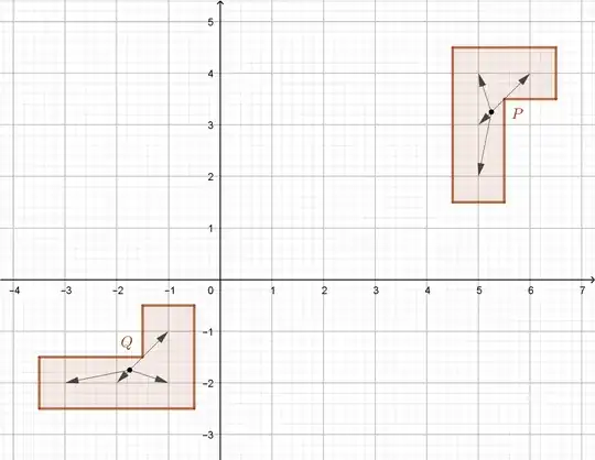

Assign Gaussian integer coordinates to the centres of the squares in a given $n$-polyomino, compute their centroid (i.e. their arithmetic mean), and replace the coordinates with $n$ times their offsets from the centroid.
For example, the L-shape with centres $(3 + 3i, 3 + 4i, 3 + 5i, 4 + 3i)$ has centroid $\tfrac14(13 + 15i),$ so it is coded as $(-1 - 3i, -1 + i, -1 + 5i, 3 - 3i).$ (In any order, it doesn't matter.)
Let $(z_1, z_2, \ldots, z_n)$ and $(w_1, w_2, \ldots, w_n)$ be two such lists. They represent isomorphic polyominoes if and only if $f\{z_1, z_2, \ldots, z_n\} = \{w_1, w_2, \ldots, w_n\}$ for one of the $8$ functions $f(z) = \pm z, \pm iz, \pm\overline{z}, \pm i\overline{z}$ (forming a dihedral group of order $8$). So one only has to check $z_1$ against each of the $w_k$. If $f(z_1) = w_k,$ test if $f$ matches the two lists in some order. If not, try another $w_k$. If all such tests fail, the polyominoes are non-isomorphic.
(There's no need to use complex arithmetic, of course; it's just a convenient way of describing the functions $f$.)
Example
Two isomorphic tetrominoes.
The initial lists of pairs of integer-valued square centre coordinates are: \begin{gather*} P : [(5, 2), (5, 3), (5, 4), (6, 4)], \\ Q : [(-1, -1), (-1, -2), (-2, -2), (-3, -2)]. \end{gather*} The centroids are: \begin{gather*} P : \left(5\tfrac14, 3\tfrac14\right), \\ Q : \left(-1\tfrac34, -1\tfrac34\right). \end{gather*} The scaled offsets of the square centre coordinates from the centroids are: \begin{gather*} P : [(-1, -5), (-1, -1), (-1, 3), (3, 3)], \\ Q : [(3, 3), (3, -1), (-1, -1), (-5, -1)]. \end{gather*} The algorithm compares $z_1 = (-1, -5)$ with $w_1 = (3, 3),$ $w_2 = (3, -1),$ $w_3 = (-1, -1),$ in turn, and fails to find a match with any of them. Next, it compares $z_1 = (-1, -5)$ with $w_4 = (-5, -1),$ and finds that $f(z_1) = w_4,$ where $f(x, y) = (y, x).$ (In terms of Gaussian integers, $f(z) = i\overline{z}.$) Finally, it finds $f(z_2) = w_3,$ $f(z_3) = w_2,$ and $f(z_4) = w_1,$ and announces that $P$ and $Q$ are isomorphic.
