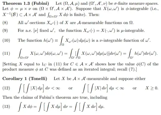

I've been introduced to the Fubini-Tonelli theorems in my probability/measure theory class in the following way: Fubini-Tonelli Theorems
or if you want a similar looking pdf: https://www.cmi.ac.in/~prateek/measure_theory/2010-10-06.pdf. Notice that all the integrals in the image and the pdf are w.r.t. measures like $\mu, \nu$ and NOT variables like $t,x,y$.
Question setup: Now, looking at the answer to the following question: Intuitive explanation for $\mathbb{E}X= \int_0^\infty 1-F(x) \, dx$, one of the integrals is $dP$ (a probability measure) and one is $dt$, which is not a measure. This makes me uncomfortable because then it doesn't "look like" we can use the above versions of Fubini/Tonelli on it, because the connotation of $dt$ is Riemann integration and not Lebesgue integration.
