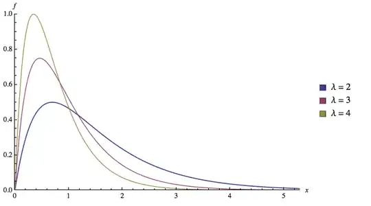

Finally, here is a quick plot of the derived pdf, as parameter $\lambda$ varies:
PlotDensity[f /. {a -> 2, \[Lambda] -> {2,3,4}}]
