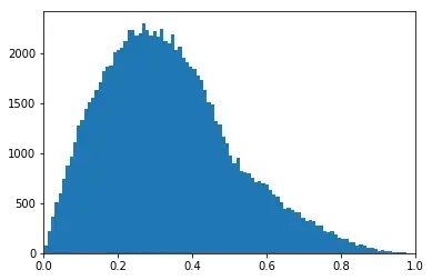

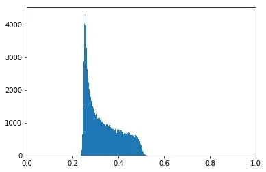

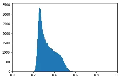

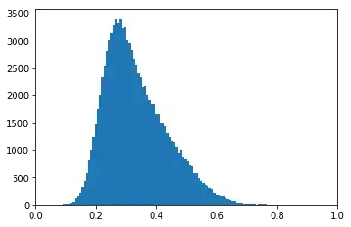

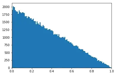

For $N=1$ we have the situation from above, but for larger $N$ I don't know how to derive this because the pdf's of the individual distances are not independent. Is it even possible to get an analytic formulation? I looked at some histograms for different $N$ and how they seem to be "evolving" in a non-trivial manner ($N=[1,2,10,100,1000]$)
N=1
N=2
N=10
N=100
N=1000
Any help in understanding this behaviour is much appreciated!
