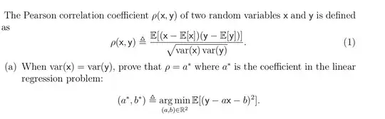

Can you help with this problem please? how to solve this problem with var(x)=var(y)
Thomas
Linear regression obtains$$0=\operatorname{cov}\left(Y-a^\ast X,\,X\right)=\operatorname{cov}\left(Y,\,X\right)-a^\ast\operatorname{Var}X,$$so in the equal-variance case$$\rho=\frac{\operatorname{cov}(X,\,Y)}{\sqrt{\operatorname{Var}X\operatorname{Var}Y}}=a^\ast.$$

  • thank you! I know the part of correlation coefficient. But I'm confused why from min linear regression you could get cov(Y-a*X,X)=0 – Thomas Nov 09 '19 at 14:39
  • @Thomas For that I recommend you learn how least-squares regression works, preferably from sources that make the geometric interpretation explicit. The key insight is that $Y=a^\ast X+\eta$ with $\eta$ a noise variable "orthogonal" to $X$, in a vector space of random variables for which covariance is an inner product. See here & here. – J.G. Nov 09 '19 at 14:54

Please show some effort. Here some hints:
  • Start from the linear regression framework and rewrite, using the linearity of expectation $E[(X-aY-b)^2]$ as a polynomial in $a,b$ ;
  • Find the extrema of the polynomial using $\partial_a=0$ and $\partial_b=0$. This is a linear system that can be solved ;
  • Compare explicitely the expression you obtain with the Pearson correlation coefficient ;
