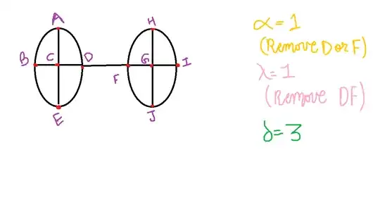

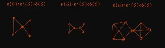

$\kappa(G)$ is the vertex-connectivity of G.
$\kappa'(G)$ is the edge-connectivity of G.
$\delta(G)$ is the minimum degree of G.
Reference
cheems
  • 285
Example
ɑ(G) is the vertex connectivity of G.
λ(G) is the edge connectivity of G.
δ(G) is the minimum degree of G.
