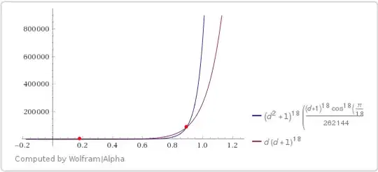

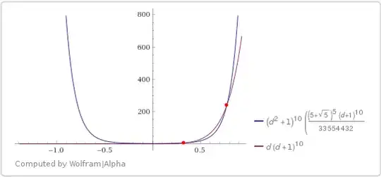

For example, let us consider the polynomials in the form of $$f^\,_k(x) = 1+x^{4k+2} = (1+x^2)(1-x^2+x^4-\dots+x^{4k}).$$ If $k=1,$ then $4k+2=6,$ $$x^4-x^2+1 = (x^2+1)^2-3x^2 = (x^2-\sqrt3\,x+1)(x^2+\sqrt3\,x+1)$$ $$=\left(x^2-2x\cos\dfrac\pi6+1\right)\left(x^2+2x\cos\dfrac\pi6+1\right)$$ $$=\left(\left(x-\cos\dfrac\pi6\right)^2+\sin^2\dfrac\pi6\right) \left(\left(x+\cos\dfrac\pi6\right)^2+\sin^2\dfrac\pi6\right)$$ Then $$f^\,_1(x)=(x^2-2zx+1)(1+x^2)(x^2+2zx+1) = (x^2-2zx+1)g^\,_1(x-z),$$ wherein $g^\,_1(u)$ is the polynomial with the positive coefficients. Easy to show that for $k\ge1$ $$f^\,_k(x)=(x^2-2zx+1)g^\,_k(x-z),\tag6$$ where $$z= \cos^2\dfrac\pi{4k+2}\tag7$$ and
$$g^\,_k(u)=\dfrac{1+(u+z)^{4k+2}}{1-z^2+u^2} = \prod\limits_{j=2}^k \left(\left(u+z-\cos\dfrac{2j-1}{4k+2}\pi\right)^2+\sin^2 \dfrac{2j-1}{4k+2}\pi\right)$$ is the polynomial with the positive coefficients.
In particular, for $$x=\dfrac z2(1+d),\quad y=\dfrac z2(1-d)$$ one can get $$x+y = z,\quad x-y = zd,\quad x^2+y^2 = \dfrac{z^2}2(1+d^2),$$ $$f^\,_k\left(\dfrac z2(1+d^2)\right) - \left(1+d\dfrac{f^\,_k\left(\dfrac z2(1+d)\right)-f^\,_k\left(\dfrac z2(1-d)\right)} {f^\,_k\left(\dfrac z2(1+d)\right)+f^\,_k\left(\dfrac z2(1-d)\right)}\right)f^\,_k\left(\dfrac z2\right)$$ $$=\left(1+\left(\dfrac z2\right)^{4k+2}(1+d^2)^{4k+2}\right) - \left(1+d\cdot\dfrac{\left(\dfrac z2\right)^{4k+2}\left((1+d)^{4k+2}-(1-d)^{4k+2}\right)} {2+\left(\dfrac z2\right)^{4k+2}\left({\large\mathstrut}(1+d)^{4k+2}+(1-d)^{4k+2}\right)}\right)$$ $$=\left(\dfrac z2\right)^{4k+2}(1+d^2)^{4k+2}\left(1-\dfrac{d\left((1+d)^{4k+2}-(1-d)^{4k+2}\right)} {(1+d^2)^{4k+2}\left(2+\left(\dfrac z2\right)^{4k+2}\left({\large\mathstrut}(1+d)^{4k+2}+(1-d)^{4k+2}\right)\right)}\right)$$ $$\le \left(\dfrac z2\right)^{4k+2}(1+d^2)^{4k+2}\left(1-\dfrac{d\,(1+d)^{4k+2}} {(1+d^2)^{4k+2}\left(2+\left(\dfrac{1+d}2z\right)^{4k+2}\right)}\right),$$
and this allows to find counterexamples
  • $k=2,\quad 4k+2=10,\quad (x,y) = \dfrac z2(1\pm d),\quad$ where$\quad z = \cos \dfrac\pi{10}\approx0.951,\quad d\in[0.328, 0.774]\quad$ (see also Wolfram Alpha calculations)
n=10
  • $k=3,\quad 4k+2=14,\quad (x,y) = \dfrac z2(1\pm d),\quad$ where$\quad z = \cos \dfrac\pi{14}\approx0.975,\quad d\in[0.229, 0.856]\quad$ (see also Wolfram Alpha calculations)
n=14
  • $k=4,\quad 4k+2=18,\quad (x,y) = \dfrac z2(1\pm d),\quad$ where$\quad z = \cos \dfrac\pi{10}\approx0.985,\quad d\in[0.181, 0.892]\quad$ (see also Wolfram Alpha calculations)
n=18
Therefore, in the case $(2.2)$ the given inequality $\color{brown}{\textbf{ allows counterexamples}}.$
