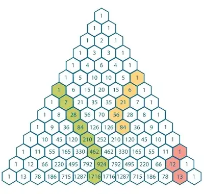

This is just repeated iterations of the Hockey-stick Identity.
Quick Overview of the Hockey-stick Identity
Here's my attempt at a more approachable description:
Notice that for each of the colors, the sum of all of the numbers in the diagonal is the last number on the bottom that goes off in the opposite direction. For instance, if we look at the yellow, we see that $1+6+21+56 = 84$.
The proof for this is very intuitive if you begin with Pascal's identity (as in, you know how Pascal's Triangle numbers are obtained). $$ \begin{align} 84 &= 56 + 28 \\\\ &= 56 + (21 + 7) \\\\ &= 56 + 21 + (6 + 1) \end{align} $$ There are lots of cool/elegant counting proofs for this identity too, but we'll skip those for now.
