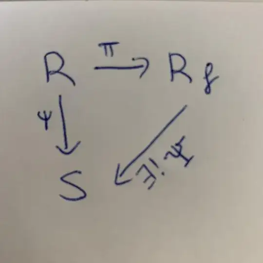

I personally find it easier to draw diagrams for something like Thm. 36, which states the following:
Thm. 36
here $S$ can be any ring, for example $R[x]/I$ with $I = ⟨−1⟩$. To apply theorem 36 you need construct such a $\psi: R \rightarrow R[x]/I$, so that
:→R[x]/I is a homomorphism of commutative rings that sends 1 to 1 such that () is a unit in R[x]/I for every ∈
as you already mentioned. You could probably construct $\psi$ through composition $\pi \circ i$ of following two homomorphisms: an embedding of $R$ in $R[x]$, $i: R \rightarrow R[x]$, $i(a) = a$ and a canocial projection of polynomials onto its equivalence classes wrt $I$, $\pi: R[x] \rightarrow R[x]/I$, $f \mapsto \overline{f} $.

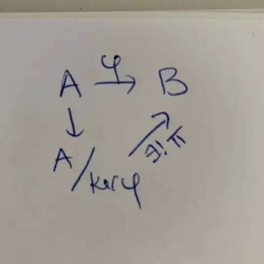

The other homomorphism you apparently get by using a "standard" universal property of rings, which yields an isomorphism, if $\phi$ is surjective:
"standard universal property"
here you have $A = R[x]$, $B = R_f$ hence $\phi$, that you constructed should probably have $\ker(\phi) = ⟨−1⟩$.

Here you take $S={\Bbb R}[x]/I$ with $I\langle fx-1\rangle$. Then $f^n+I$ is a unit in $S$, since in $S$ we have $f\cdot x=1$ and so $f$ is invertible and so is each power of $f$. Now apply the universal property above and you will get the result!
