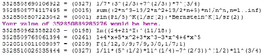

The ISC Inverse Symbolic Calculator http://wayback.cecm.sfu.ca/projects/ISC/ISCmain.html gives only a rough framework :
From Wolfram, reported by Surb : $-1+e-2\sqrt{1+e}+6\sqrt{1+e^2}+\pi^2+5\sqrt{1+\pi}$ $$\simeq 35.285088900886$$ From Claude Leibovici : $\frac{867}{22\ln(\pi)}+\frac{3\ln(\pi)}{4}$ $$\simeq 35.2850889035603$$ From Claude Leibovici : $\frac{463986e^e}{199273}$ $$\simeq 35.2850889000266$$ From my home-made ISC : $-\frac{\left(\ln(5)-\sinh(e)\right)^2}{\sin\left(25/\ln(\gamma) \right)}\quad$ , $\gamma$ is the Euler-Mascheroni constant. $$\simeq 35.285088928836$$ Even more accurately : $-\frac{\left(\ln(5)-\sinh(e)\right)^2}{\sin\left(25/\ln(\gamma) \right)}-\frac{\gamma^3\pi}{\cosh\left(e^3/\sin(2) \right)}$ $$\simeq 35.2850889285276$$ This is exactly the goal $(1)$ with 15 digits. Of course all this is not analytically true. An infinity of similar results can easily be obtained thanks to ISC as pointed out in the paper : https://fr.scribd.com/doc/14161596/Mathematiques-experimentales .
