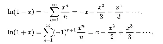

We know that Babbage's Difference Engine could calculate the sum of polynomials. This was important to him because of his work on logarithms. This relies on the sum of finite differences.
We know that we can manually calculate a logarithm using a power series.
So a logarithm can be calculated as: enter image description here
I'm trying to draw up the table of polynomial results for $\log_{e}3$ that I'd expect the Difference Engine to output.
We know that the Difference Engine tabulated polynomials using a Finite Differences Method.
My question is: What are the steps you would use to calculate $\log_{e}3$ using a Finite Differences Method?

Logarithms and the history from Babbage's time are truly fascinating.
So we start with the Binomial Expansion noting this is only useful between 0 and 1:
$$ \ln x = (x-1) - \frac{1}{2}(x-1)^2 + ....$$
We'll do this for a sixth order polynomial:
$$ \ln x = (x-1) - \frac{1}{2}(x-1)^2 + \frac{1}{3}(x-1)^3 + \frac{1}{4}(x-1)^4 + \frac{1}{5}(x-1)^5 + \frac{1}{6}(x-1)^6 $$
