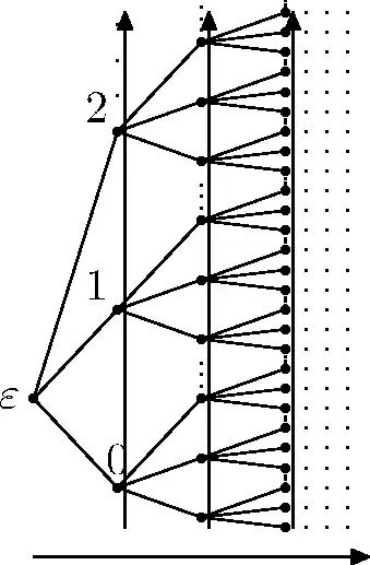

This is a visualization which I like. Imagine tree structure in the following picture - you start in the root and in each node you have countably many branches (you can number them by natural numbers).
We order all nodes from left to right and in each layer from bottom to top. (The nodes can be identified with finite sequences of natural numbers. So our ordering is that if some sequence is longer, it will be the bigger one, and if two sequences are of the same length then we look at the first position where they differ. We see that this is one of the orderings mentioned in Henning Makholm's post.) This ordering is pretty similar to lexicographical ordering and verification that we get a well-ordered set is similar as for the lexicographic order.
Note that if we stop after fist column, we just get $\omega$. If take the first two two columns, we get $\omega^2$ (since $\omega+\omega^2=\omega^2$.) So the ordinal of the whole set is certainly at least $\omega=\sup\limits_{n<\omega}\omega^n$. But this set is precisely the union of the segments, which consists of initial $n$ columns, so it is precisely equal to $\sup\limits_{n<\omega}\omega^n=\bigcup\limits_{n<\omega}\omega^n$.
