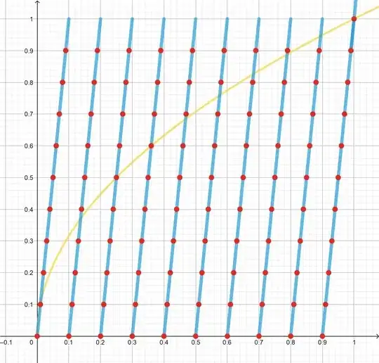

Below an approximate plot of the function $f$ in the range $[0,1]\times[0,1]$.
Red dots represent points actually belonging to the graph of $f$. The yellow line represents the graph of $$s(x) = \sqrt x.$$ By self-similarity, a scaling of $10^{2k}$ of the $x$-axis and of $10^{-k}$ of the $y$-axis, for any $k\in \Bbb Z$, would give an exact replica of the given plot.

Aside from the trivial intersections between $f$ and $s$, that is all the points with coordinates
$$\left(10^{2k},10^k\right),$$
there are many other interesting intersections, such as (limiting ourselves to the range shown in the picture)
$$(0.25,0.5),$$ $$(0.36,0.6),$$ $$(0.0121,0.11),$$ and 'trikiest' ones, such as $$(0.5776,0.76),$$ or even $$(0.35295481,0.5941).$$
