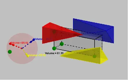

Line $(3)$ [Edited to add the following, which may start to answer my question] I can picture and understand as a stepped version of the right-angled tetraga in Fig. 2 below.
Fig. 2
Tetragonal numbers

Inspired by Sum of Consecutive Squares Formula Proof $$S_n = \sum_{k=1}^n\binom{k+1}{2}$$ $$3S_4 = \begin{matrix} 1 && 1 && 4\cr 12 && 21 && 33\cr 123 &+& 321 &+& 222\cr 1234 &&4321 && 1111\cr \end{matrix}$$
$3S_4 = \begin{matrix} 6\cr 66\cr 666\cr 6666 \end{matrix}$
$6S_4 = \begin{matrix} 66666\cr 66666\cr 66666\cr 66666 \end{matrix}$
$$S_4 = {4(4+1)(4+2) \over 6}$$ $$→ S_n = {n(n+1)(n+2) \over 6}$$
