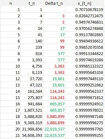

I was looking at sequences $x_n=\{n\alpha\}$ with $n=1,2,\cdots$ and $\alpha\in [0, 1]$ an irrational number. Such sequences are known to be equidistributed, so they get arbitrarily close to any number $x\in[0, 1]$, time and over. The brackets represent the fractional part function.
There is a subsequence $t_n$ of indices such that $x_{t_n}$ is the $n$-th record: it corresponds to the largest value observed sequentially, that is, $t_n$ is the smallest index such that $x_{t_n} > x_{t_{n-1}}$. Here $x_{t_{n-1}}$ is the previous record. In short, $t_n$ is the arrival time (index) of the $n$-th record. The sequence $t_n$ is strictly increasing and never ends. For $\alpha = \sqrt{2}/2$ (our focus in this question) we have:
I did not expect to see such a pattern. What's more,
$$t_{2n+1} = \Big\lfloor \frac{\sqrt{3+2\sqrt{2}}}{2}\Big(3+2\sqrt{2}\Big)^{n}\Big\rfloor,$$
$$t_{2n} = \Big\lfloor \frac{\sqrt{2}}{2}\Big(3+2\sqrt{2}\Big)^{n}\Big\rfloor.$$
Let us denote as $u_{2n+1}$ and $u_{2n}$ the expression inside the brackets $\lfloor \rfloor$ in the above twin formulas for $t_{2n+1}$ and $t_{2n}$. We have: $u_n - t_n \rightarrow 0$ (whether $n$ is even or odd) and the convergence is very fast.

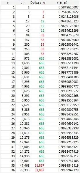

Anyone interested in proving this result? It is based solely on empirical evidence. A similar result seems achievable for $\sqrt{3}/2$. Now for non-algebraic number, the kind of periodicity observed here is lost, but we get very intriguing results, with more mysterious patterns. Below is the data for $\alpha = \log_2 3$:
The nice pattern seems to end abruptly beyond the data being displayed here, and indeed the next maximum take places at index 190,537 and 10,781,274. I could not find the next one, maybe due to machine precision or due to a massive gap.
I am very interested in some asymptotic value for $t_n$ especially when $\alpha$ is not an algebraic number. I am surprised that the arrival times $t_n$ of the successive records behave so much differently than if the underlying sequence $\{n \alpha\}$ was truly random (I studied the random case here.)

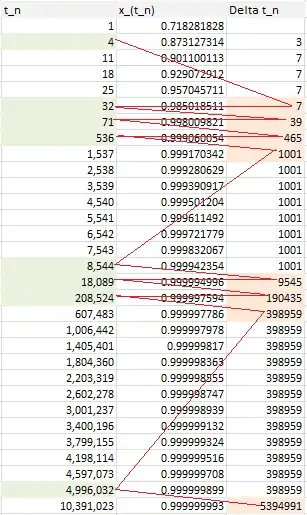

So here is how it works. No proof here, but I am showing the pattern for all irrational numbers.
The above table is for the number $e$ but it works the same way for all irrational numbers. Follow the red path! The convergents of $e$ are listed below (source: here). Look at the denominator of each convergent to identify the pattern:

    The pattern is there, but it looks a little sporradic! I believe using the over-estimate rather than under-estimate convergents would give a nicer pattern without needing $\Delta t_n$ Edit: maybe the reason it's partially working is because the over/under estimates frequently share denominators? – ketchupcoke Aug 28 '19 at 18:26
  • From my initial experiments, I believe you are right. – Vincent Granville Aug 28 '19 at 18:31
