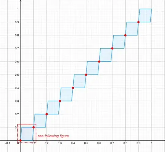

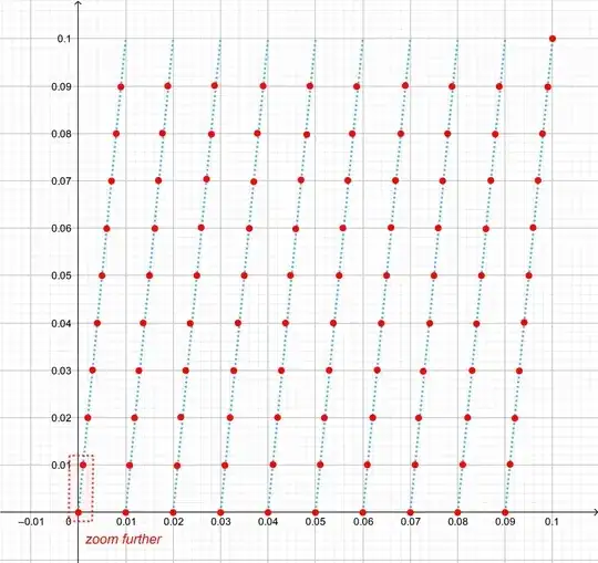

How the function graph looks like
In the first figure below you see an approximate plot of $f(x)$, the red dots representing some of the points that belong to the grah of $f$. The function is constrained within the light blue regions.
Figure 1
These regions can be obtained by shifting the first one of them, which is plotted, after magnification of a factor $10$, in the following figure. Again red dots are points belonging to the graph of $f$. A further zoom by a factor $100$, and a scaling of the $y$ axis, will give as result an identical copy of the graph given below. And so on for every interval of the form $x\in[0,10^{-2k+1}]$, $y\in [0,10^{-k}]$, $k\in\Bbb Z^+$.
